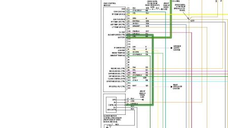

Fan speed switch won't work on any speed but we can hot wire it and it will work on all speeds.We have replaced the resister,the fan andtryed a new switch from the salvageyard but nothings working.

You have a problem between this two-the HVAC control or the blower motor control processor.
https://images.2carpros.com/forum/automotive_pictures/12900_blower_motro_1.jpg
