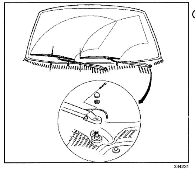

My windshield wipers on my car were working fine the other day and then when I was driving home in the rain the passenger side wiper slowly stopped working. The driver side wiper is fine but the other hardly moves anymore. How do I fix it?

It sounds like the wiper arm has come lose. Can you check the arm nut to make sure it is tight?

Yep that was the problem all right the spline was a little messed up but one it was tight everything worked great! I love this site

Hi, my left windshield wiper has stopped working the right one still works. the left one starts to go up and stops and goes back down. how can i get it to start to work again?

Locate at the bottom of the wiper arm is a nut it may be covered by plastic
adjust where it need to be and tighten the nut.

Snow in the path of the wiper arms can damage the splines of the arms. I would grab each arm and see if you can manually rotate it on the pivot. If you can, you need arms. If not, you may be able to loosen them at the pivots, make sure the system is off and parked, place the arms in true park position and tighten or install them.

Drivers side wiper does not work--passenger side ok. Think wife tried to run wipers and they were frozen under ice.

Remove plastic cap at base and check that nut is tight.

That fixed the problem--Thanks for your help
