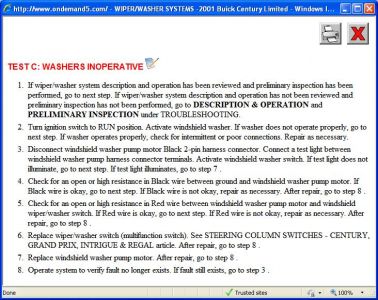

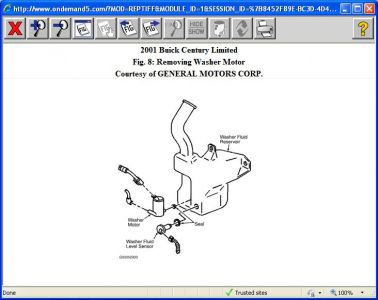

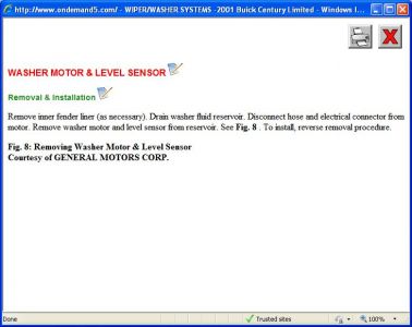

My 2001 buick century windshield washer pump doesn't work.
It looks like access is through the fenderwell.
What do I have to do to get access to replace that motor?
I would rather not take out the battery and battery support pan if it's possible to get access otherwise

There you go i even posted how to test if it was a bad pump.

That was easier than I expected. Having a start point helped quite a bit. Thanks saturntech9, poofy27
