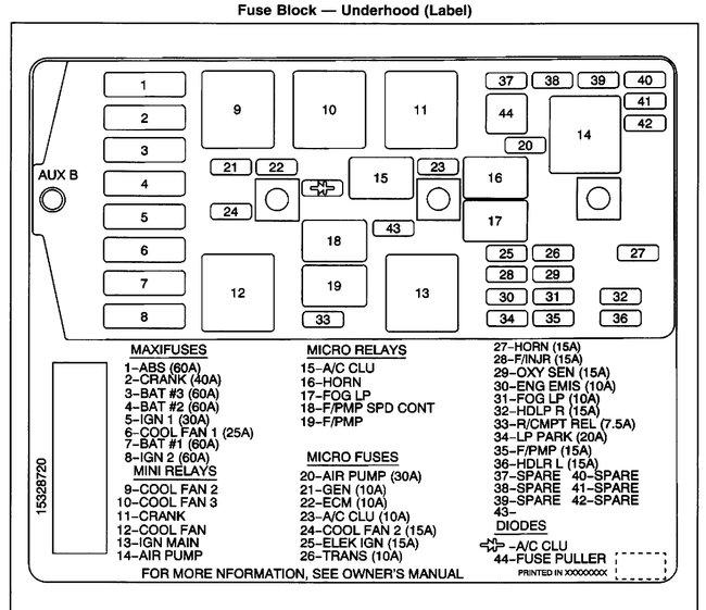

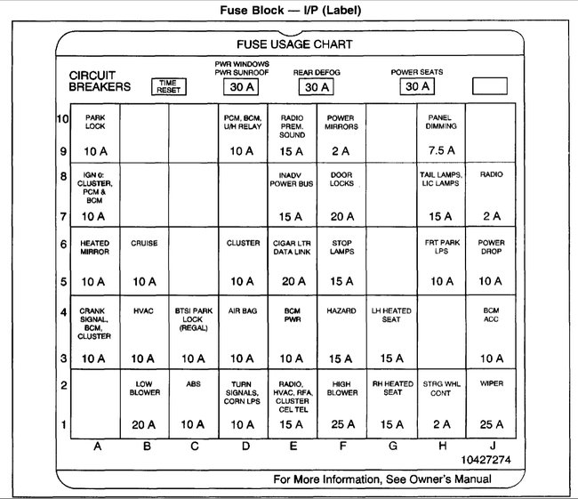

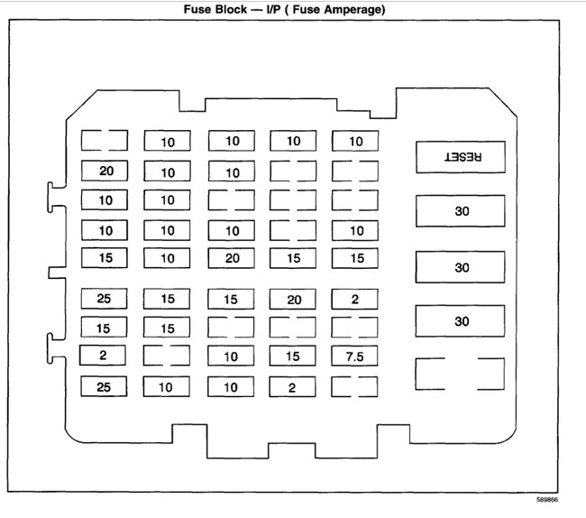

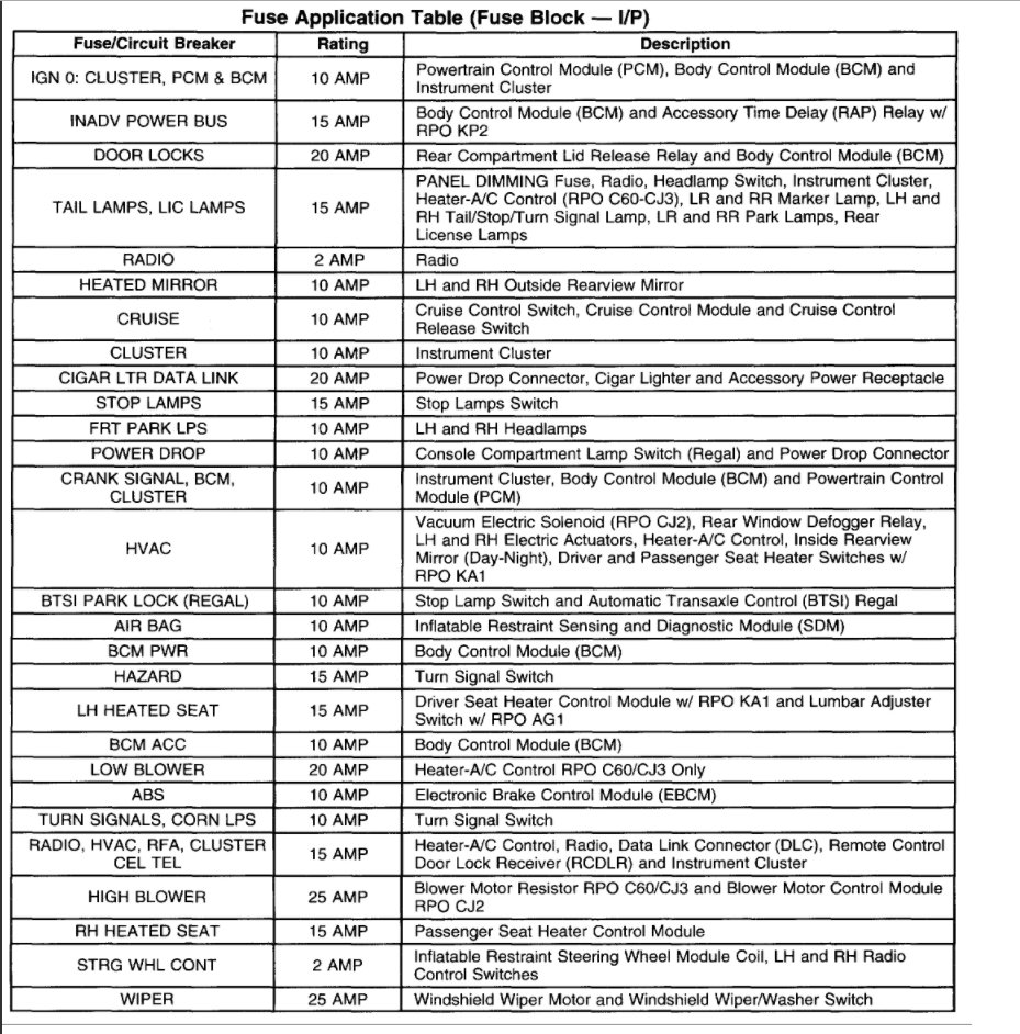

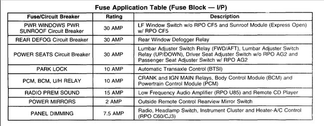

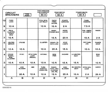

don't have owners manual for wife's car...she can't tell what gear she is in and can't see the odometer...need to know which fuse it would be?
Jan 11, 2010 at 3:32 AM
DOCFIXIT
  • 18,828 POSTS
Hello, Here is a guide and some fuse diagrams (below) to help you get the problem fixed. https://www.2carpros.com/articles/how-to-check-a-car-fuse 10 amp cluster fuse
https://images.2carpros.com/forum/automotive_pictures/198357_Graphic_323.jpg
Here are LARGER diagrams (below)
Jan 11, 2010 at 7:04 AM
JOSHUAZACHEIS
This model of vehicle has a very common problem with the resistor falling off in the instrument cluster, more specifically four of them fall off due to the poor solder quality on the resistors. I highly doubt it is a fuse, however you can check the labels on the cover of the fuse panel. Should you replace the fuse and it still doesn't work it would be a resistor problem. You can find some resistors at Radio Shack for about $5.00 plus a solder kit if you don't have one for about $10. You will need four 1/8 Watt 150 Ohm resistors as I would replace all of them so you don't have to worry about any others falling off in the future.
