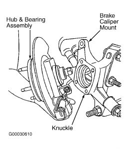

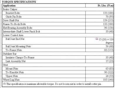

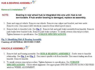

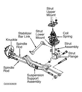

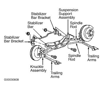

Recently, the lights came on dash indicating problem with ABS and Low Trac. Intermittenly these light go off. Took it to a garage and they indicated that a Speed Sensor is required on right passenger side therefore a new hub is required after an electrical check was done. Can I do repair myself with basic tools? Please advise. Thanks.
Jan 21, 2009 at 10:36 AM
ZACKMAN
  • 4,202 POSTS
Basic tools are all you need.
https://images.2carpros.com/forum/automotive_pictures/55316_01centuryrearhub_1.jpg
https://images.2carpros.com/forum/automotive_pictures/55316_01centuryrearhub3_1.jpg
Figure 3
https://images.2carpros.com/forum/automotive_pictures/55316_01centuryrearhub1_1.jpg
Figure 1
https://images.2carpros.com/forum/automotive_pictures/55316_01centuryrearhub2_1.jpg
Figure 2

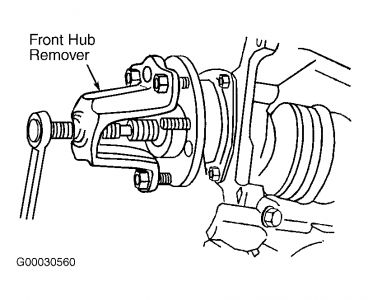

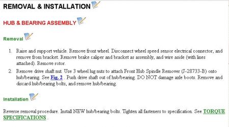

Sorry, I received your message but forgot to mention that the problem relates to the right FRONT
on passenger side for the 2001 Buick Century. Instructions related to the rear. Could you forward instructions for the front instead?
RT Bailey
Jan 23, 2009 at 12:49 PM
ZACKMAN
  • 4,202 POSTS
The website is having difficulty accessing our online service manual for the moment. If you bear with me until such time the problem is fixed, I will have the instruction posted.
Jan 23, 2009 at 11:27 PM
ZACKMAN
  • 4,202 POSTS
https://images.2carpros.com/forum/automotive_pictures/55316_01centuryfronthub1_1.jpg
https://images.2carpros.com/forum/automotive_pictures/55316_01centuryfronthub_1.jpg
https://images.2carpros.com/forum/automotive_pictures/55316_01centuryfronthub2_1.jpg
