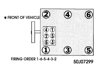

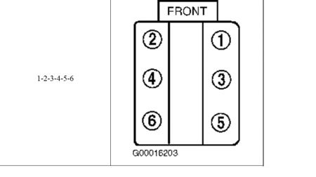

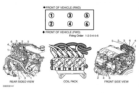

Six cylinder 3.1L engine two wheel drive automatic.
I just changed spark plugs and my car now is in rough idle and sputtering. I used Autolite platinum. I want to know the spark plug order. I numbered my wires and I may have messed it up. Is it -2-3 along the fire wall with 1 being on the passenger side? And 4-5-6 in the front with 6 being on the passenger side. I assume that is to correspond with the numbers on the distributor cap.
Last time I changed plugs I changed wires.
Aug 24, 2010 at 2:24 AM
JDL
  • 16,098 POSTS
The part that says front in the diagram is passenger side. You have a coil pack, no distributor, correct?
https://images.2carpros.com/forum/automotive_pictures/170934_century_firing_order_1.jpg

JDL,
Thanks for the diagram. I had two and four switched. Yes, I have a coil pack. I mistakenly said distributor, also working on my old gas tractor.

the firing order is 5 2 3 6 4 1 https://www.2carpros.com/images/external/84817708.gif https://www.2carpros.com/images/external/148709066.gif

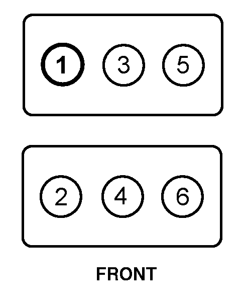

Have a century with 3.1. OBD-II says #6 cyl misfire. Looking at the engine from front of car, which cyl is #6.
Towards the firewall, the plug wire is broken. Again, it is the firewall side of engine, furtherest on the left near alternator.
I think this is #5 so why is it showing #6 misfire. A diagram would help.
Since it is not my car, I don't want to buy a manual.
Nov 26, 2020 at 2:17 AM (Merged)
DOCFIXIT
  • 18,828 POSTS
Fire wall side front to back 1-3-5. Radiator side front to back 2-4-6.

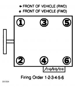

firing order for 99 buick century
  • 75,988 POSTS
Here is the engine ignition Firing Order 1-2-3-4-5-6 Check out the diagrams (Below). Please let us know if you need anything else to get the problem fixed.

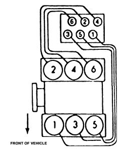

firing order 3.8.
https://images.2carpros.com/forum/automotive_pictures/1639_38_1.jpg
firing order 3.1, 3.4.
https://images.2carpros.com/forum/automotive_pictures/1639_3134_1.jpg

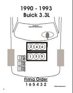

LEGITIMATE007
  • 5,121 POSTS
firing order and wire order for buick 3.3 v6
https://images.2carpros.com/forum/automotive_pictures/88091_buick_33_1.jpg

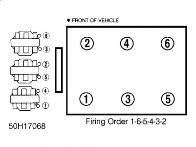

LAKEFRONTLIVIN
How come the #4 plug wire is going to cylinder #2. I hope I'm reading the diagram right ??

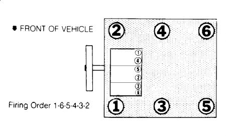

Try one of these. Late 92 (sometimes known as 1993)
https://images.2carpros.com/forum/automotive_pictures/55316_92centuryfiring_1.jpg
1993
https://images.2carpros.com/forum/automotive_pictures/55316_93centuryfiring_1.jpg

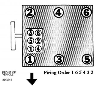

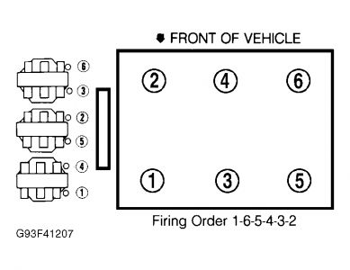

which is the Number one spark plug when you are standing in front of the car. Wires were pulled off my car and I don't which is number one or two or six. and what is the firing order.
Nov 26, 2020 at 2:18 AM (Merged)
JDL
  • 16,098 POSTS
3.3 litre engine
https://images.2carpros.com/forum/automotive_pictures/170934_33_litre_engine_1.jpg
Firing order is 165432.

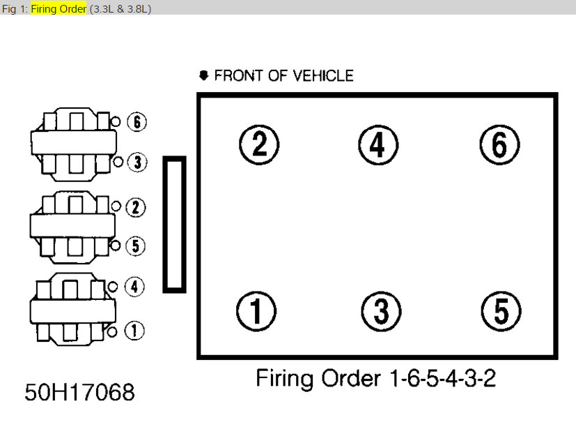

CEDWARDS08
Engine Mechanical problem
1989 Buick Century 6 cyl Automatic
i need to know the firing order of the coil pack for a 1989 buick century
Nov 26, 2020 at 2:19 AM (Merged)
BMRFIXIT
  • 19,053 POSTS
https://images.2carpros.com/forum/automotive_pictures/99387_Graphic1_94.jpg
https://images.2carpros.com/forum/automotive_pictures/99387_Graphic2_49.jpg
