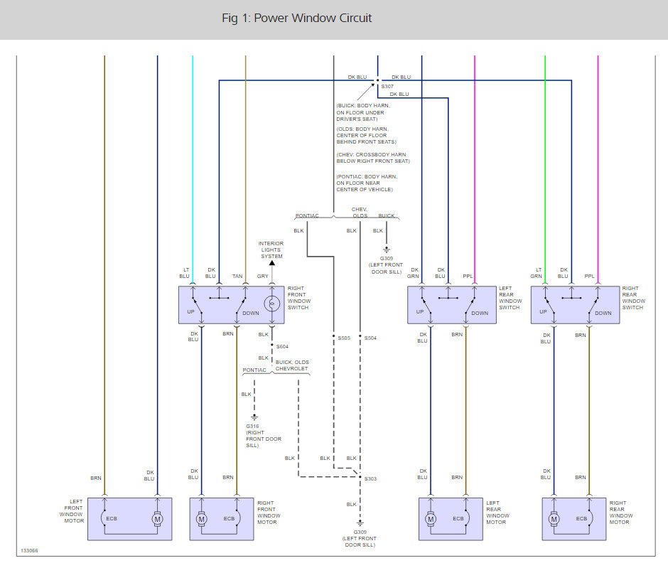

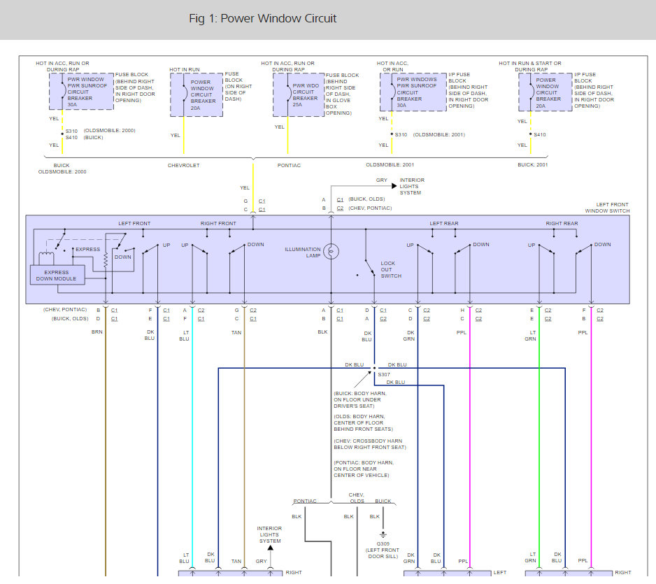

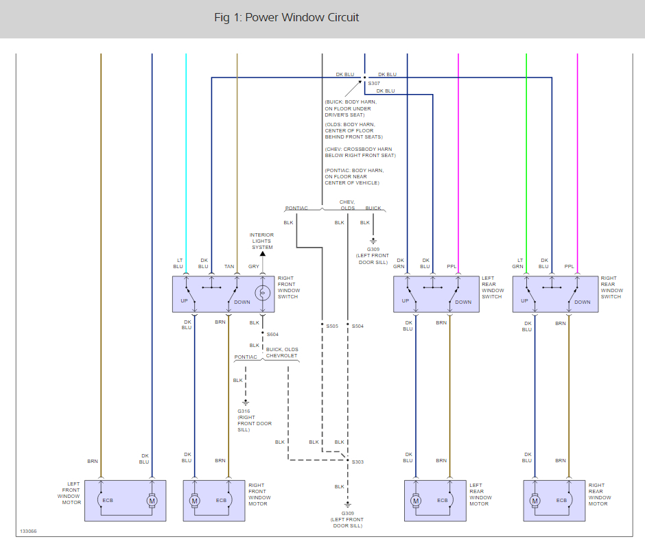

The power windows in my Buick will not work. When the problem first occurred the windows worked sporadically. Now they do not work at all. I have replaced the main switch on the drivers side and it has not helped. It makes a buzzing sort of noise when you press the drivers side window button but nothing happens. The windows will not work from any of the other door switches either.
Jun 27, 2009 at 10:16 AM
  • 55,202 POSTS

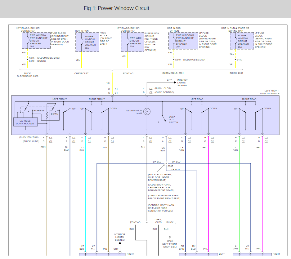

It sounds like the system has a bad ground. This can be caused by a broken wire in the drivers door between the jam and the door. Here is a wiring diagram so you can do some testing along with a guide.
and
https://www.2carpros.com/articles/electric-window-repair
Please run this test and get back to us we are interested to see what it is.

Hello, I'd start by looking at the power window circuit breaker. Pull the circuit breaker, turn on the key, use a testlite see if there is voltage available at the breaker.

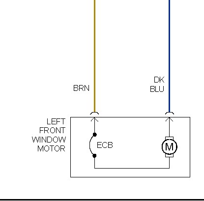

Was the master switch new? I'd remove the door panel to get at the window motor. If you have good voltage and ground at the wiring connector, I'd have to suspect the window motor.
Because it is a reversing motor, the wires in the diagram, switch between voltage and ground, depending on up or down.

Do you have a multimeter to do some tseting?Sounds like you could have a broken wire in the door wire boot that runs from the body of the car to the drivers door.

What year is your car 2000? if so there is no BCM that controls the windows you can see from the posts above in the window wiring diagrams.
