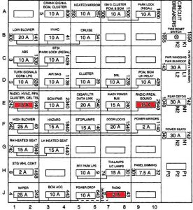

cd/ tape deck not working since changing battery
Apr 14, 2009 at 6:28 AM
ZACKMAN
  • 4,202 POSTS
Start by checking these 3 fuses in the fuse block.
