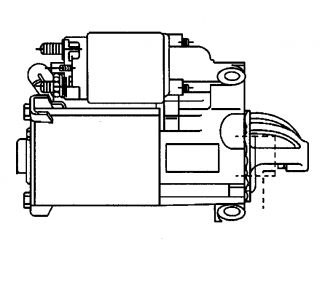

the battery and alternator seem to be o.k. all lights work etc. the starter is not even clicking as it would with a dead battery.I need to know how to jump across the starter and where it is on this model.

its in front of the car jump S terminal to battery volts (large wire on the starter relay)
https://images.2carpros.com/forum/automotive_pictures/99387_starter_1_1.jpg
