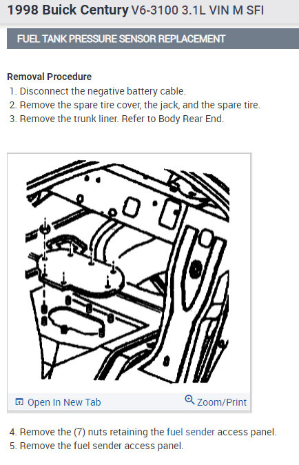

where is the fuel tank pressure sensor located?
1999 BUICK CENTURY
209,242 MILES • 6 CYL • FWD • AUTOMATIC
WJJBABY
Also how to remove it on the car listed above Custom?
Aug 22, 2009 at 7:24 PM
SQM
  • 6,383 POSTS

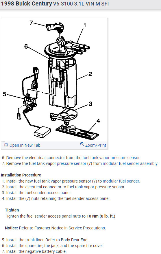

The fuel tank pressure sensor is located on top of the fuel pump sending unit (see diagram).
There is an access panel in the trunk, you can use that to access the sending unit.
After removing the electrical connector to the pressure sensor you will be able to remove it.
Remember to disconnect the negative battery cable before starting the process.
