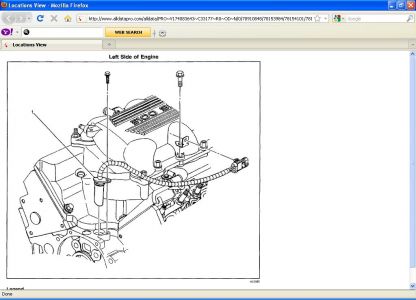

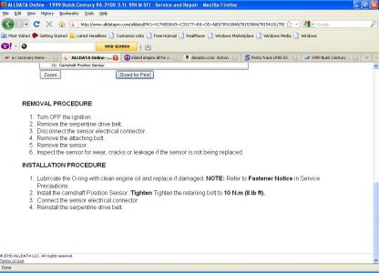

I have a 1999 Buick 3.1L 6 cylinder Buick century and need to replace the cam position sensor. How do I get to it and how do I replace it?

There you go.
