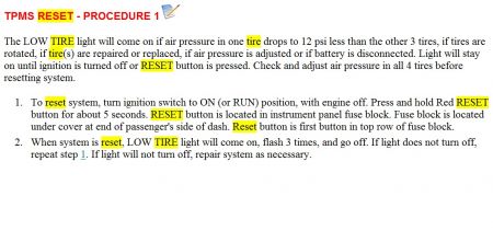

1999 Buick Century 6 cyl Front Wheel Drive 159,00 miles
How do I turn this light off? I have checked all the tire pressures including the spare and they are within manufacture specs.
May 8, 2010 at 7:59 AM
INTERNETMECHANIC
  • 700 POSTS
Your talking about the tire pressure monitor system?
https://images.2carpros.com/forum/automotive_pictures/512072_tire_pressure_monitor_system_1.jpg
