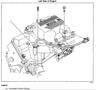

REMOVAL PROCEDURE
https://www.2carpros.com/forum/automotive_pictures/12900_camshaft_8.jpg
Turn OFF the ignition.
Remove the serpentine drive belt.
Disconnect the sensor electrical connector.
Remove the attaching bolt.
Remove the sensor.
Inspect the sensor for wear, cracks or leakage if the sensor is not being replaced.
CPS 7X

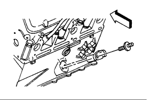

REMOVAL PROCEDURE
https://www.2carpros.com/forum/automotive_pictures/12900_crk1_1.gif
Turn the steering wheel fully to the left.
Raise vehicle on hoist. Refer to Vehicle Lifting in Service Precautions.
Disconnect the electrical connector.
Remove the retaining bolt.
Remove the sensor from the engine.
If the sensor is not being replaced inspect for the following:
7.1. Inspect the sensor for wear, cracks, or leakage. Replace the O-ring if necessary.
7.2. Lubricate the new O-ring with clean engine oil before installing

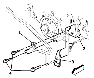

CPS 24X
REMOVAL PROCEDURE
https://www.2carpros.com/forum/automotive_pictures/12900_crk2_1.gif
Remove the serpentine drive belt from crankshaft pulley.
Raise the vehicle. Refer to Vehicle Lifting in Service Precautions.
Remove the crankshaft harmonic balancer retaining bolt.
Remove the crankshaft harmonic balancer.
Note the routing of sensor harness before removal.
Remove the harness retaining clip (3) with bolt (4).
Remove the sensor bolts (2).
Remove the sensor.
