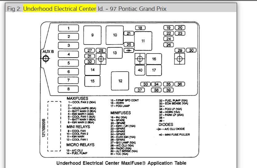

My trunk remote does not work, and the key does not turn the trunk lock. Is there any otherway to get into the trunk other than removing the back seat?
I can't find any button in the glove compartment.
Thanks
Frank
Mar 15, 2009 at 3:47 PM
ZACKMAN
  • 4,202 POSTS

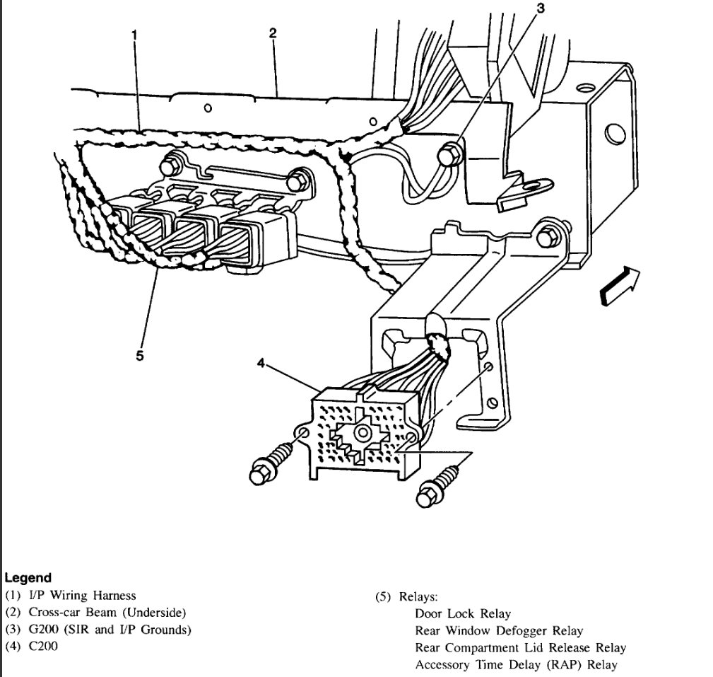

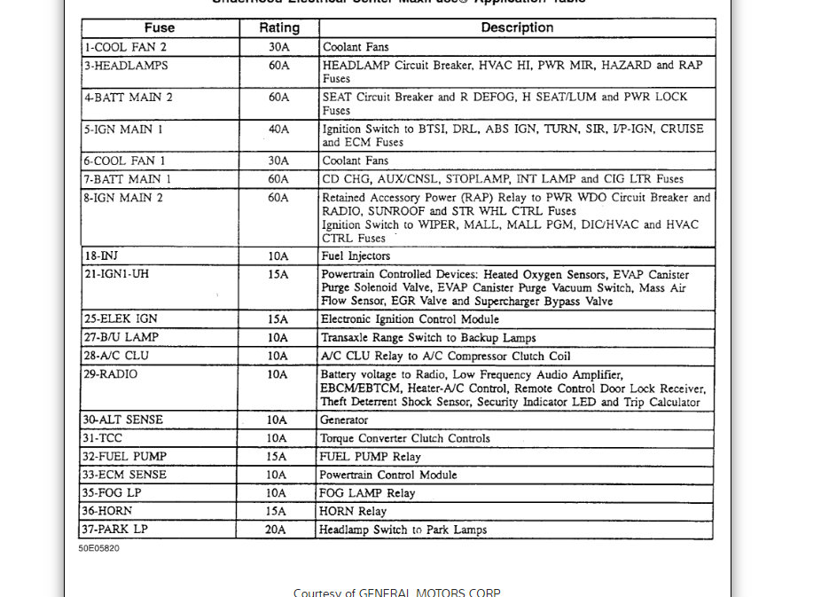

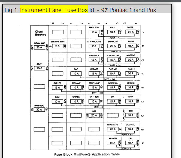

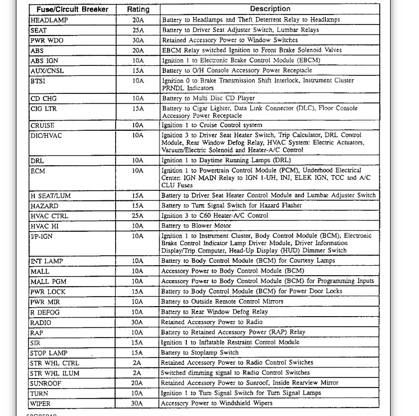

I would start by checking the trunk relay and fuse. Here are two guides and the locations of the relay and fuse.
and
Check out the diagrams (Below). Please let us know what you find.
Cheers
Mar 15, 2009 at 4:58 PM
BELIKEGOD
I had this problem it was the relay. :) Thanks for the guides.
