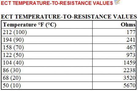

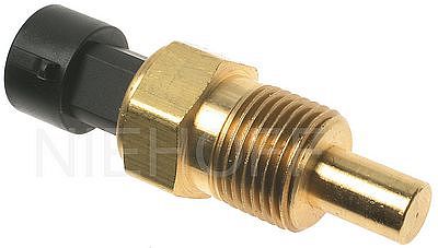

when sitting in traffic my tempuratue gauge goes past the mid point i have no leaks in the cooloing system it has been preasure tested good my electric fans work only when i put the ac on shouldnt they also come on when the temp reaches a certain point?
the thermostat has also been tested good im thinking either a temp sensor or a fan control module
any help would be appriciated
