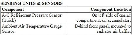

Electrical problem
1998 Buick Century 6 cyl Two Wheel Drive Automatic 29.870 miles
exterior temp gauge shows minus degrees, so ac not working
Apr 13, 2009 at 4:15 AM
ZACKMAN
  • 4,202 POSTS
Check both of these
https://images.2carpros.com/forum/automotive_pictures/55316_98centurytemp_1.jpg
