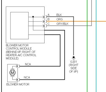

1997 Buick Century How do I fix the fan on my car?
1997 BUICK CENTURY
1,500 MILES • 6 CYL • 2WD • AUTOMATIC
JULIEK1B
The A/C Heater blower isn't working when I turn it on nothing happens I have a step by step way to do this but need a schematic of the componant panel so when I open it up I know what I'm doing.
Oct 30, 2010 at 12:47 PM
JDL
  • 16,098 POSTS
With key on and hvac turned on, I'd check good voltage and ground at the blower motor, if voltage and ground are ok and no blower action, suspect the blower motor.
https://images.2carpros.com/forum/automotive_pictures/170934_century_blower_motor_1.jpg
Oct 30, 2010 at 1:10 PM
JULIEK1B
What next steps should I use? I am not a mechanic and I have no idea. I just need a step by step way so I can have someone help me check to see. Thanks for the schematic it is very helpful. And do you know how much blower motors costs if this is the culprit?

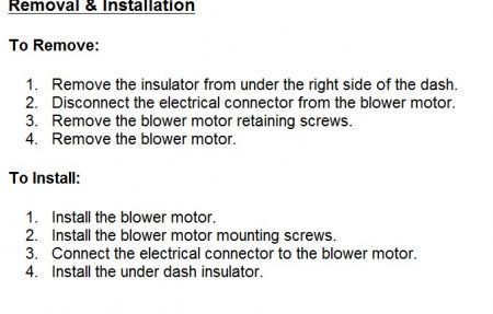

JDL
  • 16,098 POSTS
Sorry I can't lead you step by step, I'd have to look at it. If the blower is the problem, the removal and install is listed below. The Napa online partsbook, list the part for 90 bucks plus tax. You might be able to find one cheaper, you will have to look around.
