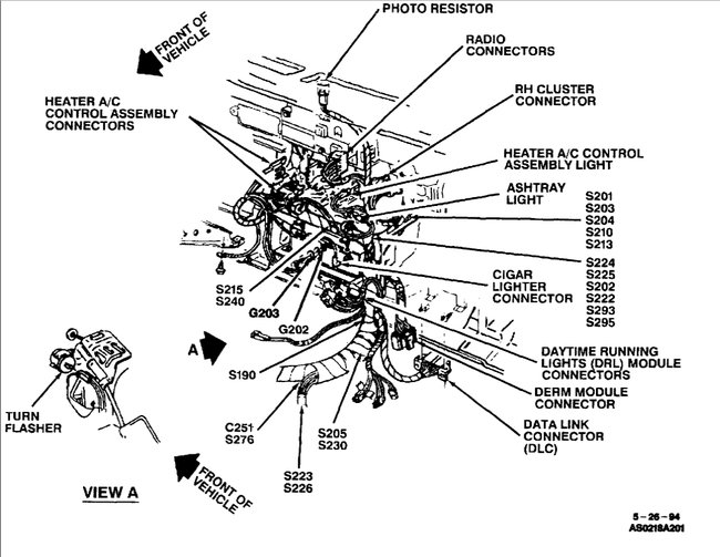

I found the blinker location, above the gas pedal mount, following pink and purple wires, however, I can't find the second "can" for the hazards. Other answers say at the "convience center". What is that and what does it look like? I see something that "sort of" looks like the can, but it is plastic and says "pontiac coil".
Mar 21, 2009 at 11:27 AM
JDL
  • 16,098 POSTS
Hello, look above the driver side kick panel the hazard flasher is in the convenience. center could be on the back of it.
https://images.2carpros.com/forum/automotive_pictures/170934_flasher_2.jpg
Check out the diagrams (Below) Please let us know what happens. Cheers

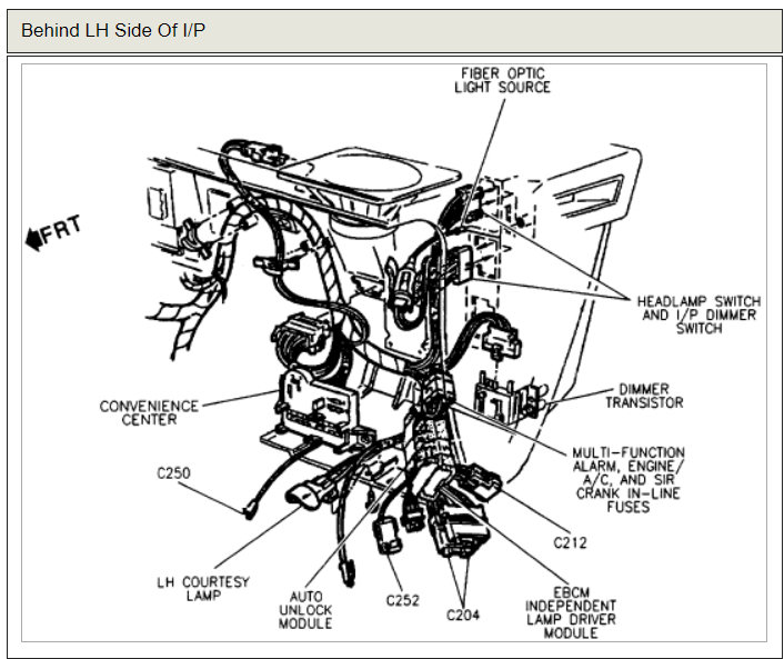

I have hung upside down under the steering column for 30 minutes looking everywhere for the hazard flasher can with all the kick plates removed. I see a huge electrical plug above the left kickplate and I see the blinker can on the mount for the gas pedal, but I don't see anything else but wiring harnesses. Then I looked behind and into the convenience center and there is whas thanks 2Carpros I love this site.
Feb 3, 2021 at 4:13 PM
JDL
  • 16,098 POSTS
https://images.2carpros.com/forum/automotive_pictures/170934_flasher_3.jpg
Hello again, I looked at two different databases, they showed the same location. The databases are not always correct. The two I looked at, probably get their info from the same source. Glad we can help. Please tell a friend.
