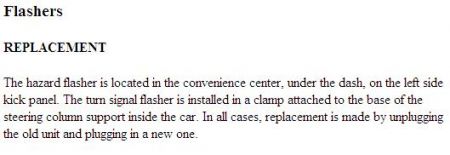

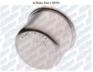

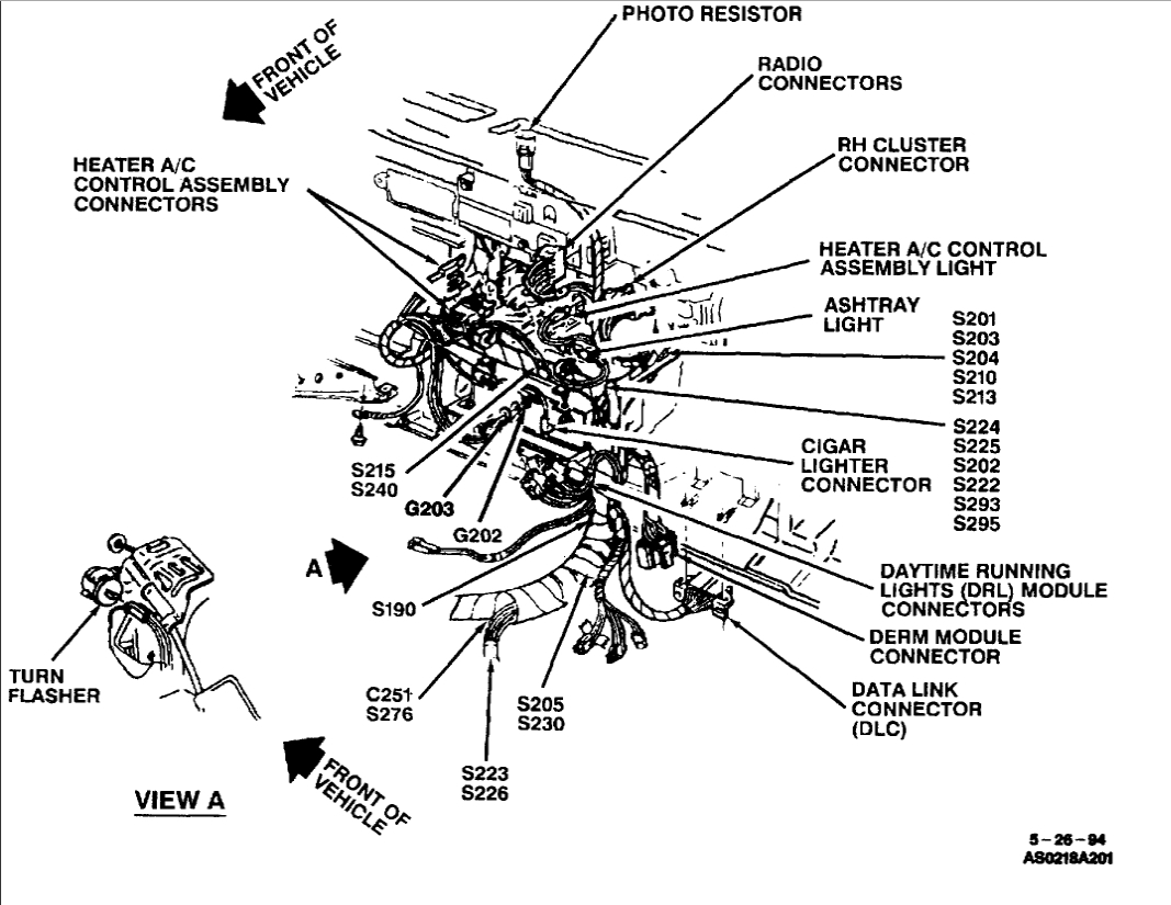

I found the blinker location, above the gas pedal mount, following pink and purple wires, however, I can't find the second "can" for the hazards. Other answers say at the "convience center". What is that and what does it look like? I see something that "sort of" looks like the can, but it is plastic and says "pontiac coil".

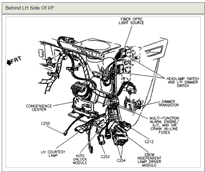

Hello, look above the driver side kick panel the hazard flasher is in the convenience. center could be on the back of it.

Check out the diagrams (Below) Please let us know what happens. Cheers

I have hung upside down under the steering column for 30 minutes looking everywhere for the hazard flasher can with all the kick plates removed. I see a huge electrical plug above the left kickplate and I see the blinker can on the mount for the gas pedal, but I don't see anything else but wiring harnesses. Then I looked behind and into the convenience center and there is whas thanks 2Carpros I love this site.

https://images.2carpros.com/forum/automotive_pictures/170934_flasher_3.jpg
Hello again, I looked at two different databases, they showed the same location. The databases are not always correct. The two I looked at, probably get their info from the same source. Glad we can help. Please tell a friend.
