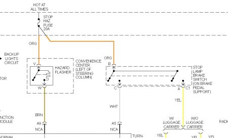

Hello gentlemen. I have a 95' Buick Century. Whenever I turn the headlights on the fuse for my brake lights blows out. The brake lights and running lights stop working along with dashboard and interior lights. There is an after market stereo installed and the headlight switch has been replaced with a new one from the dealer. Any help is greatly appreciated especially if you can upload a wiring diagram. Thank you.

Here's one for the brake switch. When the brake switch is activated, the yellow wire carries voltage for the high-mount brake lites. The white wire carries voltage for the lower brake lites and is wired through the turn signal switch.
https://images.2carpros.com/forum/automotive_pictures/170934_century_brake_switch_1.jpg
