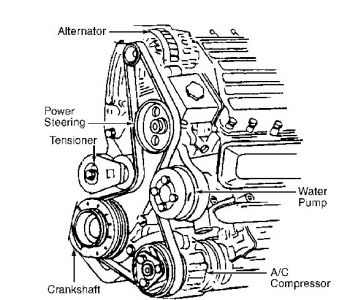

Where can I find the Serpentine belt diagram on my car? I know it's normally under the hood, but cannot locate. If someone has a diagram that I could print out that would be great. Also, what is the easiest way to change the belt tensioner?

https://images.2carpros.com/forum/automotive_pictures/30961_3onebelt_1.jpg
Release the tension from the belt, pell the belt off the tensioner. Rleace tensioner, re-install belt.
