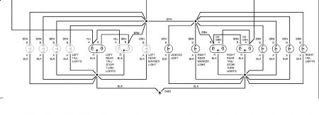

OK, so my girlfriend got rear ended recently and had to have a used tail light bar put on because apparently they dont make new ones anymore. A couple days ago, her tail lights stopped working. I say take it back to the shop but her dad blew that all to hell by telling the shop that the problem was under the dash (i doubt it). I haven't had a chance to tear into it yet, but I cannot find a wiring digram for the tail lights anywhere. Supposedly the fuses are good but im going to double check. Also, its just the tail lights, brake lights and blinkers still work fine. Any help or schematics would be much appreciated

Voltage for the taillamps is wired through the headlamp switch. There is a taillamps fuse, not only check the fuse, use a voltage tester, make sure the circuit is hot. The brown wire at the rear is voltage for taillite, black wire is ground.
https://images.2carpros.com/forum/automotive_pictures/512072_century_taillamps_1.jpg
