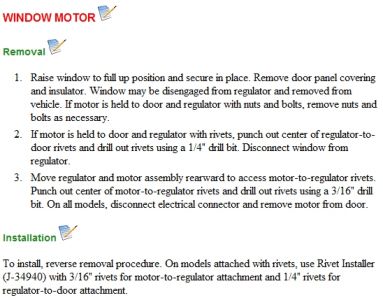

how can i take out and replace a window moter wend there are no screews, just spike on the back in the window panel that hold the moter, there no way to get in the door panel without cutting, how can i replace the moter wend it not screews that is holding it

https://images.2carpros.com/forum/automotive_pictures/261618_Noname_2114.jpg
