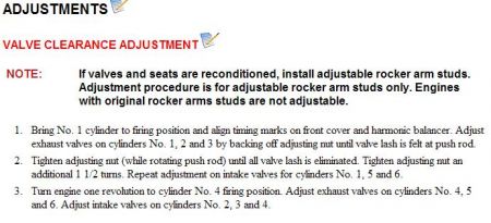

I recently changed head gaskets and intake manifold gaskets and was wondering what is the correct way to adjust the valves? It has stock roller lifters. Thank you for your time.

Hi there, see text for valve clearance adjustment procedure. mark (mhpautos)
