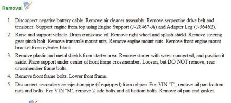

how do you get the oil pan out to replace

Hi there, oil sump removal as per Mitchell 1. Mark (Mhpautos)
