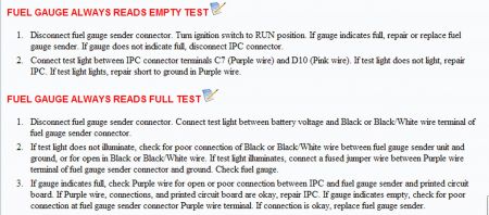

Looking at buying a 1994 Buick Century. The gas gauge, shift indicator and volt meter don't work. I can get a replacement cluster but need an idea of how difficult it is to replace. I've already seen that these have a cable problem for the shift indicator.

You may not need to replace the cluster! Does the gas gauge read always full, or empty?
https://images.2carpros.com/forum/automotive_pictures/62217_Tests_3.jpg
