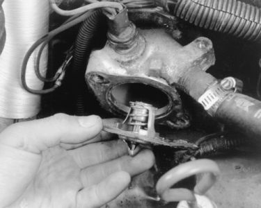

Should look like the picture below..
https://www.2carpros.com/forum/automotive_pictures/261618_0900c15280216410_4.jpg
Was it installed like that?
Saturday, February 14th, 2009 AT 8:45 PM
TIMMESSINA
  • 10 POSTS
Yes it was
