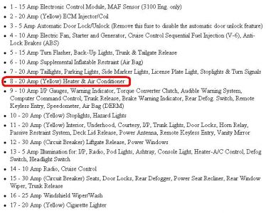

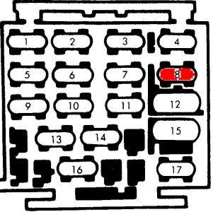

Where is the fuse for the heather blower localate

Also check your blower motor relay on the relay bracket, under the hood, right front of the engine.
