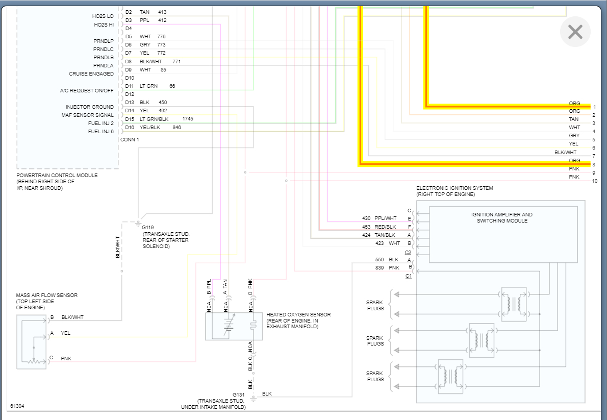

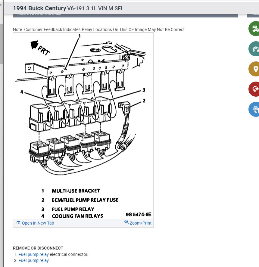

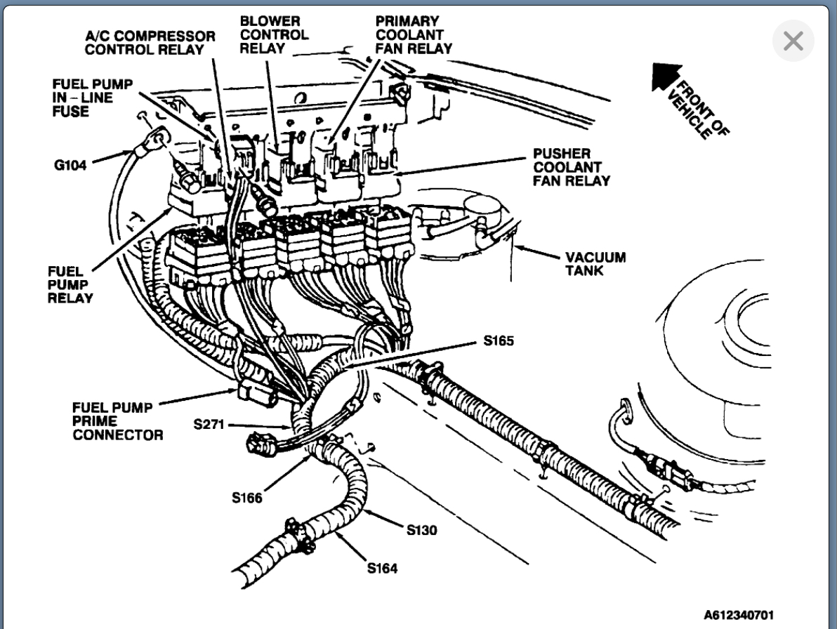

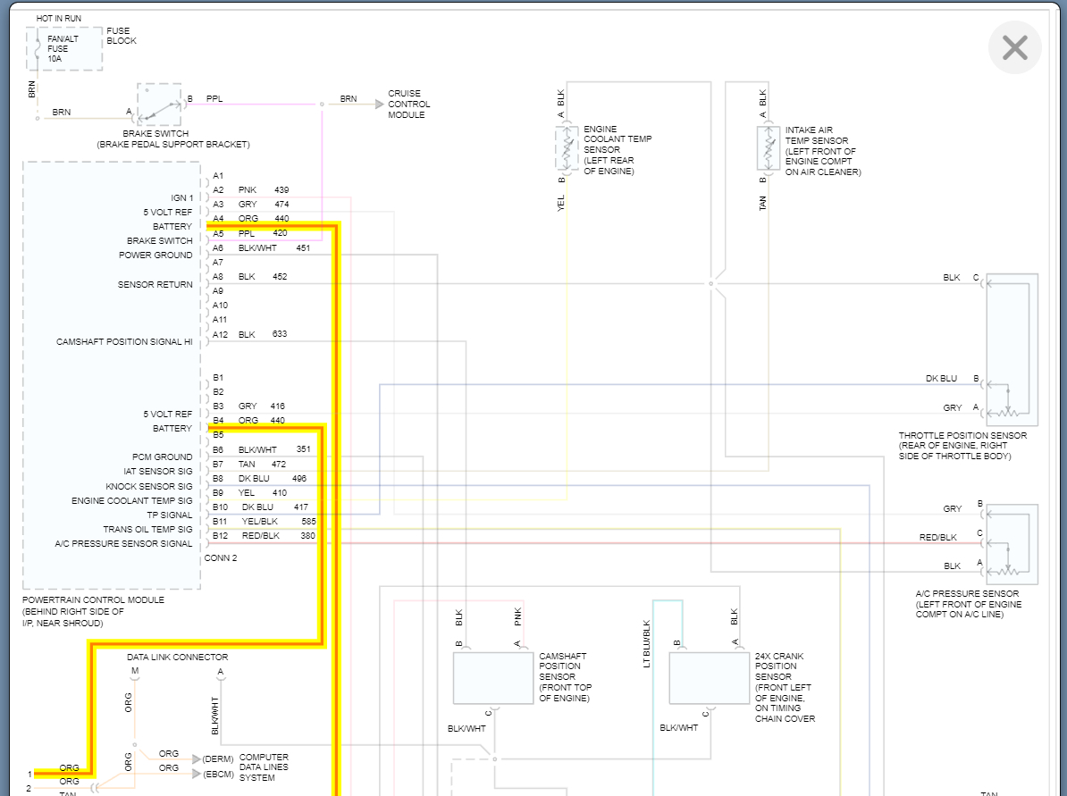

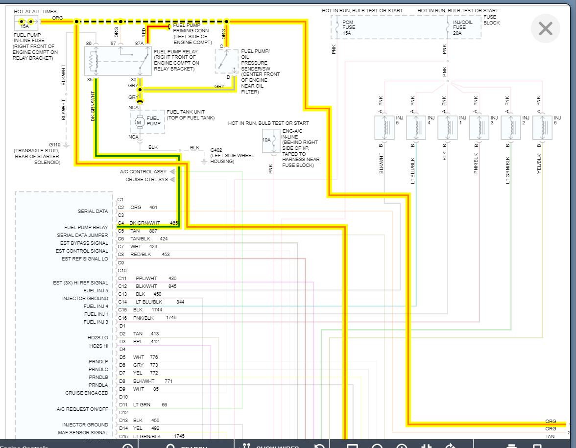

Just replaced the fuel pump in a 94 century. without cking the electrical relay-fuse. Where can I get a fuel pump diagram that includes electrical. Or how can I ck the relays/where are they/more than one? PLEASE!!!
Sep 8, 2010 at 10:30 AM
  • CAR REPAIR CONTRIBUTOR
I will include all the diagrams and info below on the fuel pump relay and electrical circuit.
Here are a couple guides that will help with testing this in case you need it:
Also here is a guide that will help doing this testing.
Please see the info below on the relay including the wiring diagrams and process on how to replace it. Let us know if you have other questions. Thanks
