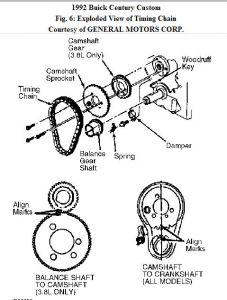

1992 Buick Century 6 cyl
how do i line up the timing chain marks
Aug 9, 2008 at 10:39 AM
OBXAUTOMEDIC
  • 3,711 POSTS
Here is the diagram for lining up timing marks...
