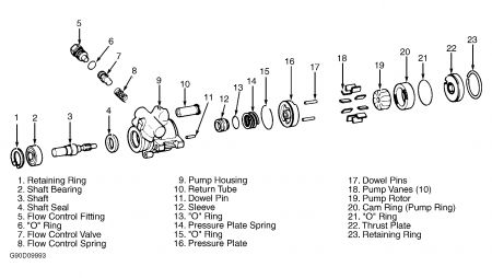

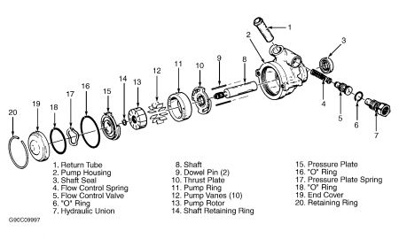

All the nuts and bolts are removed and I stlll can't lift it out. Have the gear puller and need to know when it comes in to play...also would like to know where I can down load an exploded drawing or picture of the unit...any additional info will be greatly appreciated. Thanks, Bil

Hello . thanks for the donation ..much appreciated .. There are 2 types of pump fitted to your model .. have included diagram of both .. hope this helps POWER STEERING PUMP PULLEY Removal Remove drive belt. It may be necessary to remove power steering pump for clearance (leave hoses connected to pump if possible). See POWER STEERING PUMP . Install Pulley Remover (J-25034-B) on pulley. While holding remover body with wrench, turn center bolt clockwise to draw pulley off shaft. Installation Using Pulley Installer (J-25033-B), press pulley onto shaft until face of pulley hub is even with end of shaft. DO NOT use a press to install pulley. If pump was removed, install pump. Fill and bleed hydraulic system. See HYDRAULIC SYSTEM BLEEDING under LUBRICATION. POWER STEERING PUMP Removal Remove drive belt. Remove belt tensioner (if necessary). Remove pump pulley. See POWER STEERING PUMP PULLEY . Disconnect pressure line from pump. On vehicles with pump adaptor, disconnect return line from pump adaptor using Quick Connect Separator (J-36391). On all vehicles, remove mounting bolts. Remove pump adaptor (if equipped). Remove pump. Installation To install, reverse removal procedure. Fill and bleed hydraulic system.
https://images.2carpros.com/forum/automotive_pictures/266999_pump_cbseries_1.jpg
https://images.2carpros.com/forum/automotive_pictures/266999_pumptcseries_2.jpg

I do not have any diagrams of the actual pulley in use i'm afraid .. the outside legs of pulley remover go around the pulley .. locate centre bolt onto pump centre shaft, turn centre bolt of puller clockwise with a wrench to push down on pump shaft drawing the pulley off the pump shaft
