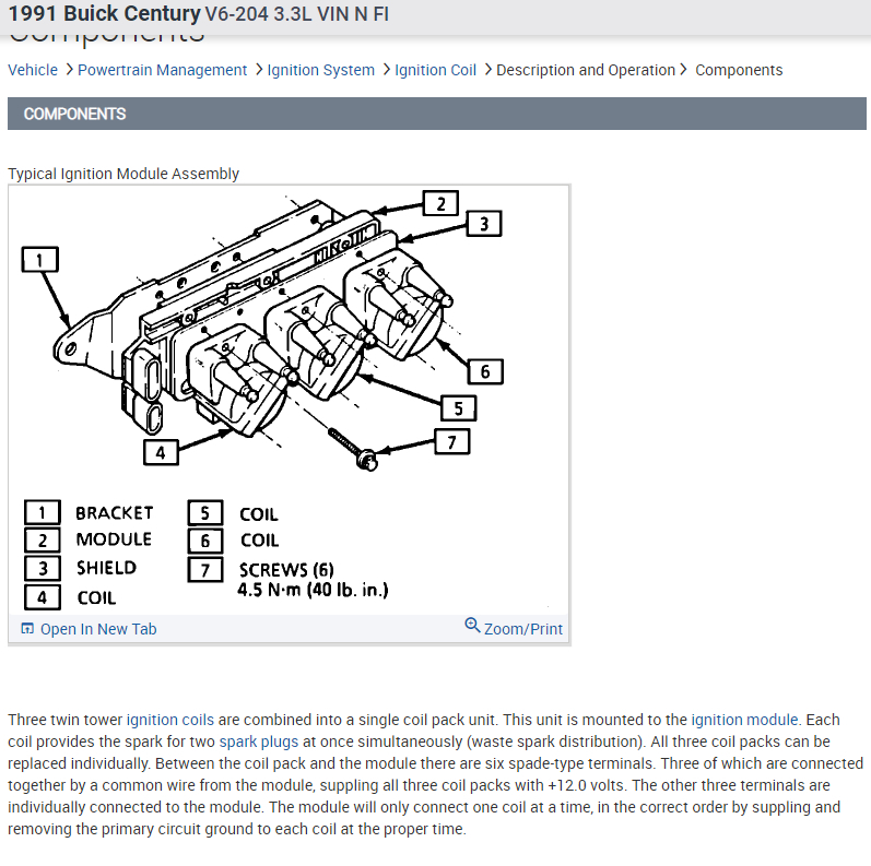

coil pack wiring and locations
1991 BUICK CENTURY
125,000 MILES • 6 CYL • FWD • AUTOMATIC
TOM KONOPKO
location of cyl viewed from radiator. wire connection to ignition coil pack
Jul 10, 2010 at 2:09 AM
SQM
  • 6,383 POSTS

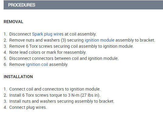

Ignition coil packs are located on top side of the engine. See attached for replacement procedure. Check out the diagrams (Below). Let us know what happens and please upload pictures or videos of the problem.
