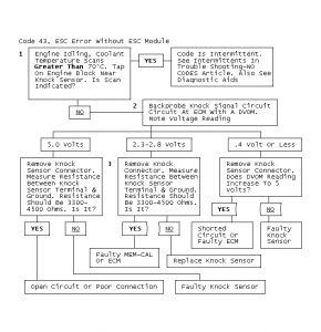

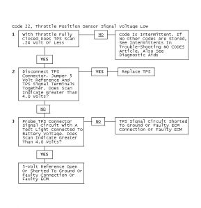

what does it indicate when fault codes can not be erased. I have a century limited that I have had for too
long now and the damn thing will not let me erase the faults 22 and 43. I have left the battery disconnected
overnight to no avail.

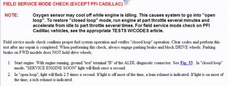

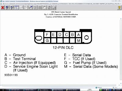

To clear the codes,turn the key on and ground terminal B on the ALDL connector Thurn the key off and remove the control mod fuse for 10 seconds, replace the fuse and the ground lead. Then do a field service check if the codes clear!

codes still present after multiple attempts to clear

Did you try tracing the knock sensor yet? Try removing the battery cable and unpluigging the ecm...
