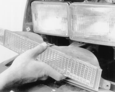

How do I get to the front (driver side) turn signal bulb to replace it?
Saturday, December 29th, 2007 AT 3:16 PM
FAIRRACING31
  • 150 POSTS

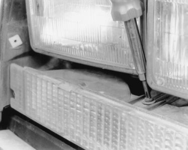

1. On some models you will need to remove the headlight bezel mounting screws and the bezel
2. Remove the mounting screws for the lamp assembly
Remove the mounting screws securing the lamp assembly
https://www.2carpros.com/forum/automotive_pictures/103836_1_1.jpg
3. After the screws are removed, pull the assembly from the vehicle
Pull assembly from vehicle
https://www.2carpros.com/forum/automotive_pictures/103836_2_1.jpg

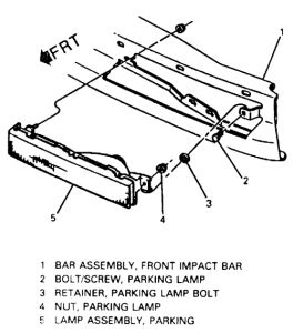

4. Disconnect the twist lock socket from the lens housing
Disconnect twist lock
https://www.2carpros.com/forum/automotive_pictures/103836_3_1.jpg

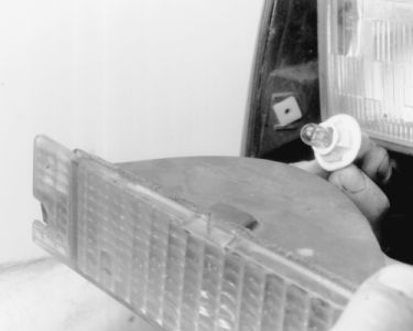

5. Remove bulb and replace
https://www.2carpros.com/forum/automotive_pictures/103836_4_1.jpg
https://www.2carpros.com/forum/automotive_pictures/103836_5newer_1.jpg

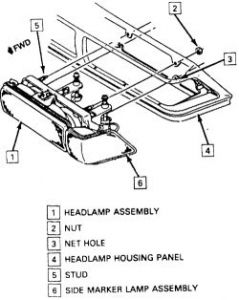

Newer models have the turn signal separate from the headlight assembly.
