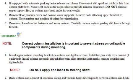

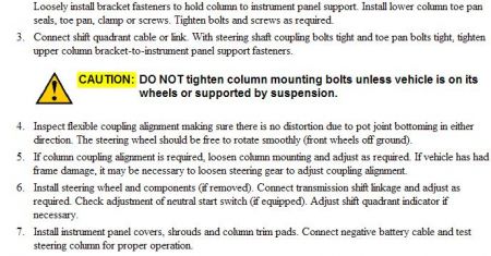

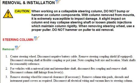

I am having trouble removing steering column to replace starter. Transmission indicator and signal linkage all fell out. Retaining ring impossible to remove. What's the secret?
