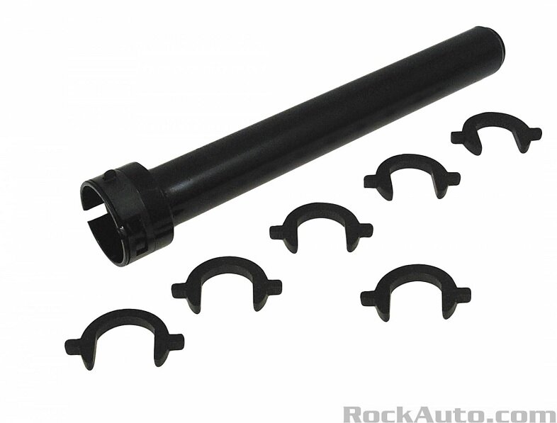

A lot of GM inner tie rod ends require a special socket with a set of different sizes of crow's foot wrenches to grab two flats on the back side of the ball and socket. Check out the first photo. You can borrow that tool from any auto parts store that rents or borrows tools. In my city, they make you buy the tool, then you get a full refund when you return it. If you choose to keep a tool, you still return it, then they order or give you a brand new one. Pick the crow's foot that fits the joint. While holding it in place, slide the socket over it so the two tabs slide into the two slots on the tube. There's a stamped steel ring to rotate that locks the wrench to the tube. Pull out gently on it to keep the wrench on the flats, then use a 1/2" ratchet to unscrew the joint. Normal threads. Turn it counterclockwise to unscrew it. Other tie rod designs require a different special socket to fit a standard hex head around the joint. Those come in two different sizes. Some of them have both sizes built into one tool. All of these are roughly 15" long to slide over the threaded shaft.
Oops, forgot to mention the accordion boot has to be removed first. There's a small spring clamp around the small end. It's common to find a squeeze band around the inner, larger end. Once the ends are snapped together, there's a section to crimp to compress and tighten that band. If you run into frustration trying to stretch them to get them off, and to squeeze them to put it together, . . . welcome to my world. Try whatever you can dream up. At worst you'll have to replace that band. In a pinch, a larger nylon tie strap will do the job. There's a special pliers to tighten the crimp when installing that band. It has a shoe in the middle to push the crimp down. That's mainly for use on CV joints where that crimp could stick up high enough to hit something as the shaft rotates. If you have the room and can fit that pliers in there, it can be used to loosen the band too. Grab the crimped section loosely, then twist the pliers left and right to tug on the crimp. That will stretch it, sometimes enough to allow the band to be unsnapped.
Be aware there's a small metal tube plugged into both of the boots. That just transfers air in them back and forth as you steer. Nothing has to be sealed, but don't forget to pop that back in when the boot is reinstalled.

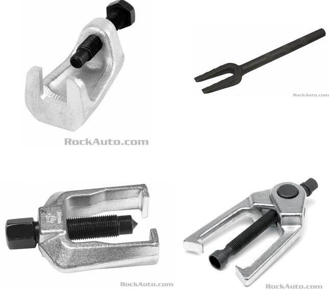

The third photo shows some tools for removing the outer tie rod's tapered stud from the steering arm. An alternative trick is to bang on the side of the arm next to the stud once the nut is removed. The shock is often enough to break the taper.

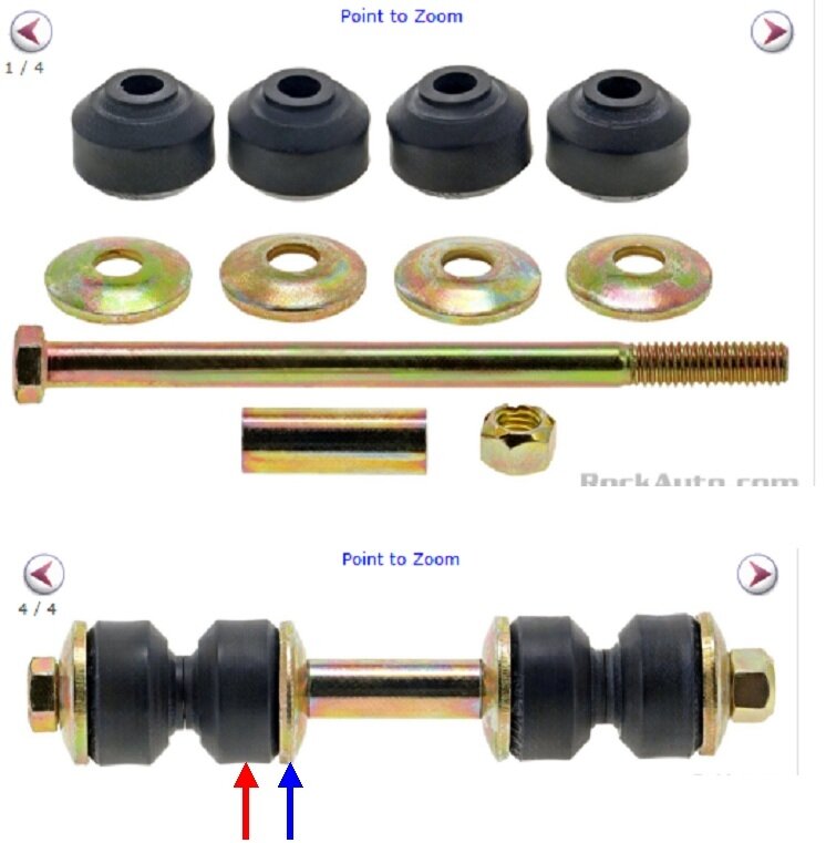

Your model uses the most common anti-sway bar link design. It has been around since forever. See the fourth photo. The top shows the pieces you get in the kit for one link. When these fail, they sound like a tambourine on bumpy roads. Getting the old ones off usually requires an air-powered cutoff tool or an angle grinder. The nuts get rusted tight and commonly round off. The big secret to these is you do not fully tighten the nut when installing them. Rather, run the nut down until the rubbers expand to exactly the same diameter as the steel washers, as shown in the fourth photo, (red and blue arrows), at the bottom. GM used to use shock absorbers with a threaded stud on top, and two rubbers like those shown here. The same applies. When tightening the nut, do so just until the rubbers expand to the same diameter as the metal washers. If those are over-tightened, they'll bind or pinch when that stud needs to tip and swivel a little as the vehicle bounces up and down.

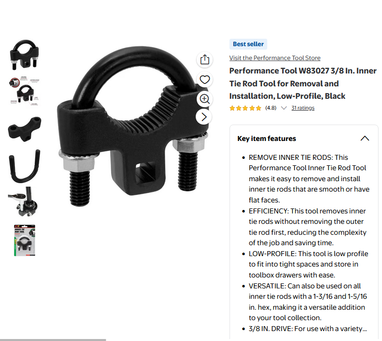

CARADIODOC, in buying an inner tie rod kit, I see the option to purchase only a single U-shaped tool with two bolts, one on each end of the U. But another option provides a set of crow-foot wrenches. Do I need both the U-bolt and set of wrenches?
At first glance, it seems I can buy only the U-bolt and a crow-foot wrench which matches my Buick 98 LeSabre.

I'm not familiar with the first one you mentioned. It sounds like it's adjustable for any size flats. I'd be skeptical of that as you may need to use considerable torque to free and tighten that part.
I have two different designs, three tools in total. One is just a six-point socket on the end of a tube long enough to go over the entire inner tie rod end. You turn that with a regular half-inch ratchet and torque wrench. The entire housing of the tie rod end is a giant hex nut. There's two different common sizes of those, so there are two tools to cover all of that design.
As a side note, there were some designs of inner tie rod ends that had an Allen head lock screw that had to be loosened first, and Ford had some with a metal pin that was driven in to prevent the hex from working loose. There were two designs of those pins too. One was removed by threading a thin, tapered tool into the center of the roll pin, then tightening a nut to pull the tool and pin out. The other design looked like a pop rivet with a hardened metal pin in its center. The only way to remove those pins was to forcibly unscrew the joint, and let the threads push the pin out, hopefully without damaging the threads on the steering gear. I haven't seen either of those designs in a really long time. I think both went away after the late 1980s.
Also going back that far, some import models required the new inner tie rod ends to be torqued to achieve a specific pulling force on the outer end of the shaft. That force was measured with a fish scale. Tightening the joint set the tension on the internal spring that put pressure on the ball. Today all inner joints have that spring pressure set during manufacture, so all that's critical is how hard you tighten the hex onto the steering gear.
The second tool design uses those crow's feet you mentioned. That's the much better tool for a rather thoughtless inner tie rod end design. Some engineer didn't realize how much simpler this could have been, but they put the two flats on the backside of the housing where a simple tool won't work. GM is famous for designs that require special tools, and this is one of them. When I bought this tool, the set included six different sizes of crow's feet. Today, I think they're up to eight sizes. Even with this sad design, the engineers can't stick to one common size. If you've never used this tool, you slide the correct crow's foot over the two flats on the back of the joint's housing, slide the tube over the crow's foot with its two tabs mating with the two slot in the tube, then you rotate a metal ring to lock the two pieces together. Pull outward toward you just a little to keep the tool engaged with the flats, then turn it with a ratchet.
it's easiest to start running the new joint on by hand first, as far as it will go, then install the tool and tighten the joint with a torque wrench. The torque spec. is 74 foot-pounds unless specified otherwise in the instructions that come with the new part.

Using the special tool is not complicated as much as it is cumbersome. You can assemble the parts on a workbench to see what it looks like.
In this first photo, it just shows the two regular sockets at the end of long tubes. You need the tool in the second photo. The new tie rod end can be used to see how it works. Pick the crow's foot that fits the two flats on the back of the joint. Slide the tube over the tie rod far enough that the two tabs on the crow's foot slide into the two slots on the tube. At that point you're ready to turn the tube / socket with a ratchet, but you have to be careful to not pull the tube off the crow's foot, or push the crow's foot off the joint. That's what the ring on the tube is for. You rotate that ring to lock the two parts together, then you can pull gently on the tube to keep the crow's foot on the joint's flats. The job would be easier if you had three hands. If you don't, you can expect to experience a little aggravation. You'll need to drop the crow's foot onto the ground at least two times, otherwise you won't have had as much frustration as the professionals experience.

Is this tool of any value? Since I plan to install both inner and outer tie rods, this probably will not save me any time.

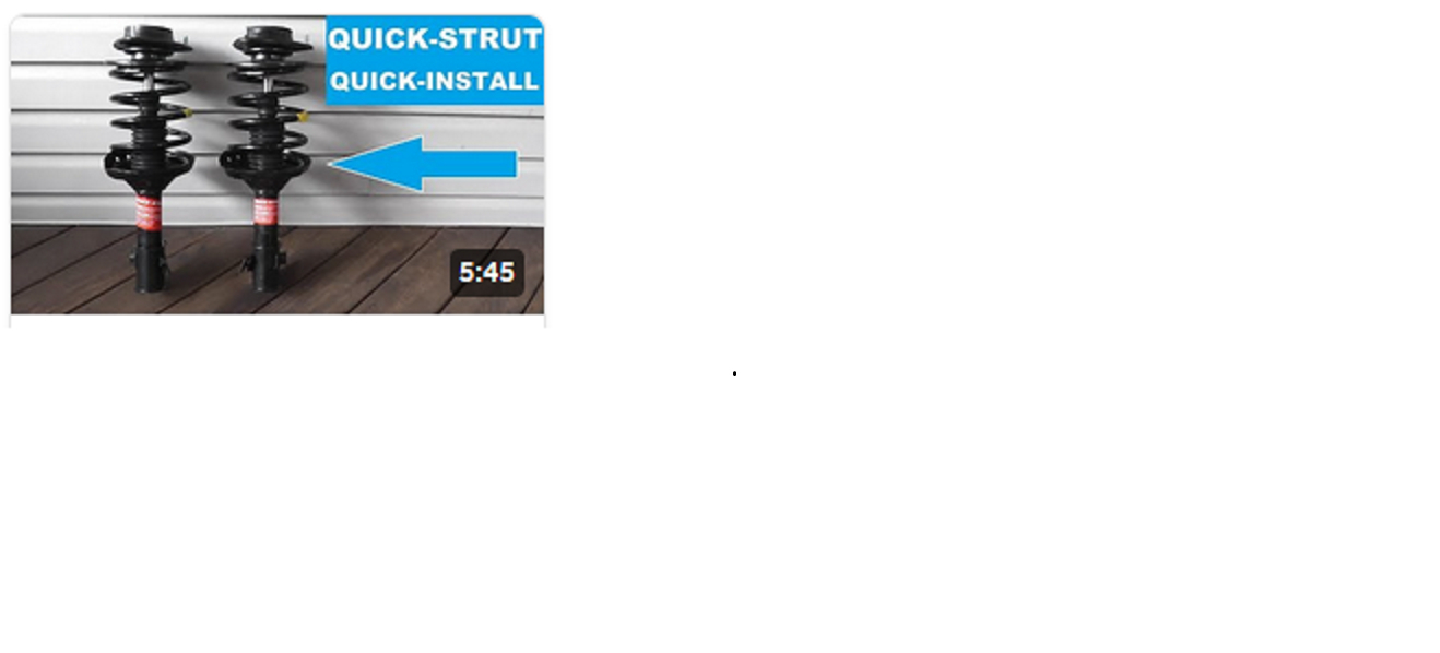

Regarding my newly-purchased Monroe Quick Strut (pair)--
Is there a video on actually releasing the Quick Strut safely from its compressed state, once it is bolted into place at the upper (body frame) end? It occurred to me that no video I have seen covers this part of the installation.

I suppose the tool you found would likely work as long as there's room to fit it in there. You'll have to really tighten the two nuts as the joint is perfectly round with no edges or corners for the U-bolt to grab onto.
The old strut assembly is going to be fully extended already when you remove it. You'll likely need a large pry bar to pry the lower control arm down to get the bottom of the strut past it. The car has to be jacked up and supported on jack stands under the frame rails, not under the lower control arms. The strut piston itself is what keeps the coil spring contained and under pressure. If you wanted to remove the spring, such as when transferring it to a new strut, you have to use a strut compressor to compress the spring only an inch or so to relieve the pressure on the strut, then you can loosen the large nut in the center of the upper mount. This is where safety becomes an issue. On almost all other car brands, if you release pressure on the coil spring, it will expand roughly another four or five inches to its free length. If it slips out of the compressor while under pressure, real damage can occur. I had one spring out, make enough racket that the office girls behind two closed doors ran out to see what happened, then it bounced out the garage door and through the parking lot. I saw another one pop straight up and take out an eight-foot light fixture.
The problem with a lot of GM springs, if one jumps out of the compressor, is they usually have a free length of a lot more than another four or five inches. Six to ten inches is common, and most spring compressors can open up far enough to grab it at both ends. That means it can't be compressed enough to fit onto the strut, with the shaft extended enough to allow installation of that large nut. Many wall-mounted strut compressors are able to open up enough to recapture a GM coil spring, but competent do-it-yourselfers don't have those. The more common and inexpensive tool is a clamshell compressor that is operated by turning a large bolt with a wrench. Again, when simply transferring the spring from an old strut to a new one, it is already collapsed most of the way when the compressor is attached. The tool only has to compress it another inch or so, just enough to take the pressure off the upper mount.

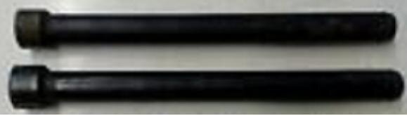

Another trick that can solve this problem is to use a pair of compressor bolts that have hooks on each end. There is still plenty of danger involved because of the high angles of the coils. The hooks on this tool tend to keep slipping around the spring, but if you can get them to stay in place, you may be able to compress the spring enough to allow the clamshell compressor to be installed on it. Some people figure out they can use Vice-Grip pliers on the spring to keep the compressor tools from sliding around, but even that is not a good idea. The black paint on the spring is there to protect them from rust. That paint shouldn't be scratched or chipped. Honda had a big problem with that in the 1980s. Rust caused springs to break, usually in the middle, and the really sharp ends created would tear the sidewall of the tire.
As long as the spring doesn't pop out of the clamshell compressor, it can be transferred like any other coil spring, but GM went further and made their spring uncommonly fat, and with odd shapes. Some won't fit inside a clamshell compressor, and some have such weird angles to the individual coils, or "loops", that it's almost impossible to get all four fingers of the compressor wrapped around part of that spring. They just made them really miserable to work with. The safety issue is gone when you install a quick strut since everything is already assembled. Working on GM front-wheel-drive vehicles makes quick struts an even better value and choice.
The new strut is going to come already fully extended in the box. You might be thinking of gas-charged shock absorbers that come strapped in the collapsed condition. While they do self-extend when the strap is cut, that has nothing to do with holding up the weight of the car. You can prove that by collapsing the shock absorber by hand, but you can't hold up that corner of the car. The gas under pressure is just to keep the hydraulic oil from foaming.
You may have also seen new struts that come banded, or strapped, in the collapsed state. That is done solely so they can be shipped in smaller boxes. You can safely cut that strap, then watch as the shaft extends on its own, rather slowly. Here again, you can collapse the shaft by hand, which proves it doesn't hold up the weight of that corner of the car. That's what the spring does.

As you can tell, I am a novice at this, so every hint is helpful
My inner tie rod tool arrives between November 2 and 9, so
I am preparing.

Today, I bought a tool to separate the ball joint without using a hammer. I hope this will preserve all the attached parts
Oct 28, 2026 at 10:25 PM
CARADIODOC
  • 34,414 POSTS
One other way is to bang on the steering arm around the tapered stud to shock the outer tie rod end loose. When that doesn't work, I'll often resort to reinstalling the castle nut upside down, then I pound on that nut. That prevents damage to the threads on both parts.
Pounding alongside the tapered stud works for ball joints too.
