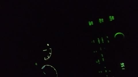

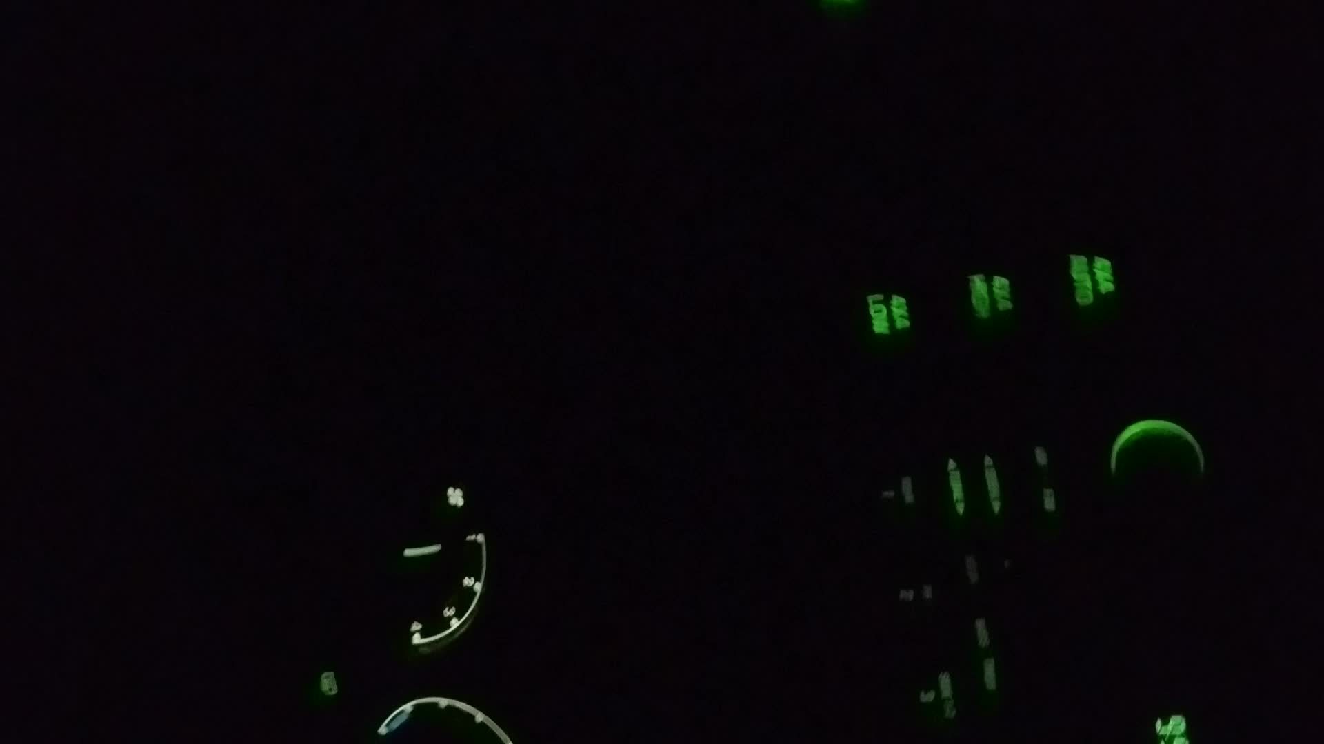

It's not as loud on the recording it sort of sounds like my tire is flat and I'm driving on it..

I heard it. Does the sound speed up as you do? If it does, have you checked CV joint and the universal joints? Is the differential fluid clean and full?
