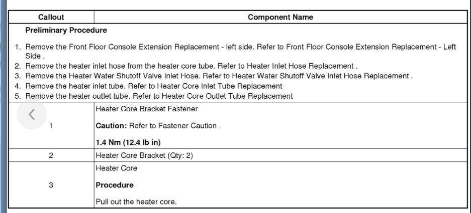

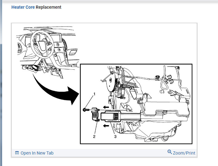

More then likely the heater core is partially plugged or leaking. Here are some guides that help with this specific issue:
https://www.2carpros.com/articles/vehicle-bubbling-noise
Even though the temperature is consistent with a functioning heater core, it still does not eliminate it as a possible cause. Did they provide the temperature differences between the hoses? The outlet should be about 20 degrees cooler and when the heat is on max the hoses should be too hot to hold.
Let us know this info and we can go from there, but I am thinking the heater core needs replaced. so here is the process just in case. Thanks

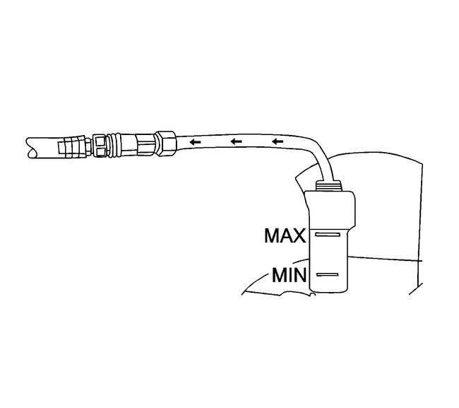

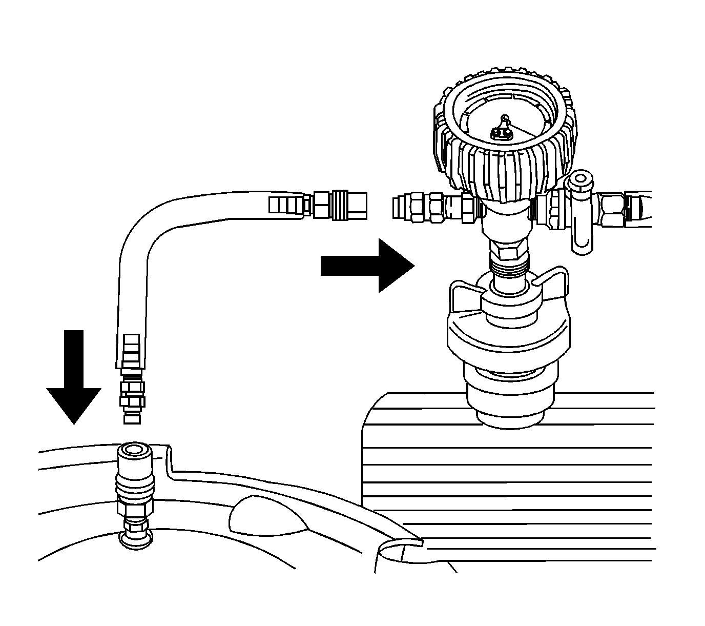

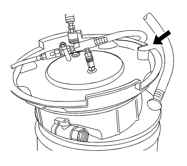

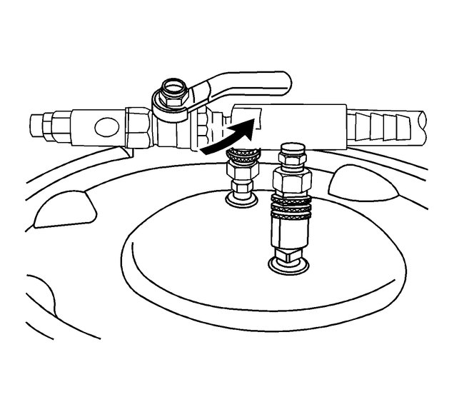

I'm not sure what all was checked by the dealer, but there is a technical service bulletin related to no heat on this vehicle. It is caused by air in the system. Here are the directions for properly bleeding the system. See if this is what they did.

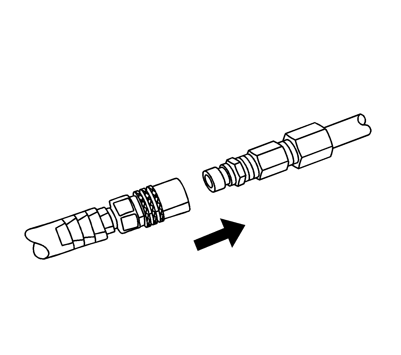

1. To drain the engine radiator, remove the engine coolant temperature sensor fron the radiator. Refer to Engine Coolant Temperature Sensor Replacement See: Engine - Coolant Temperature Sensor/Switch > Removal and Replacement > Engine Coolant Temperature Sensor Replacement
pic 1

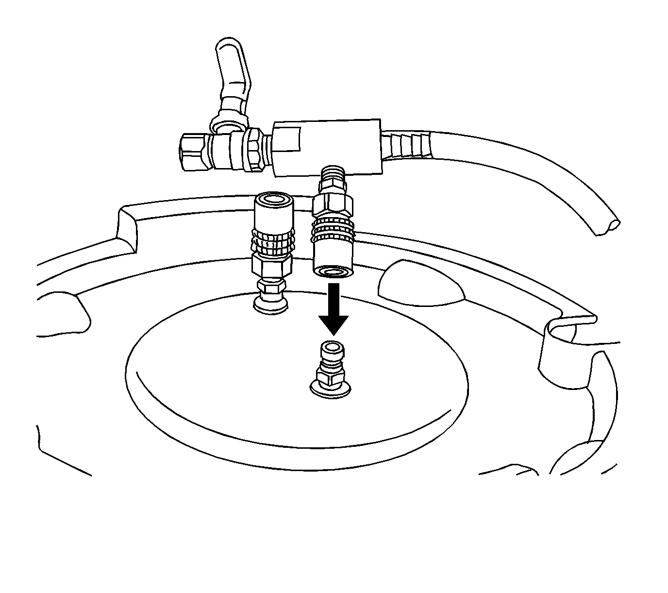

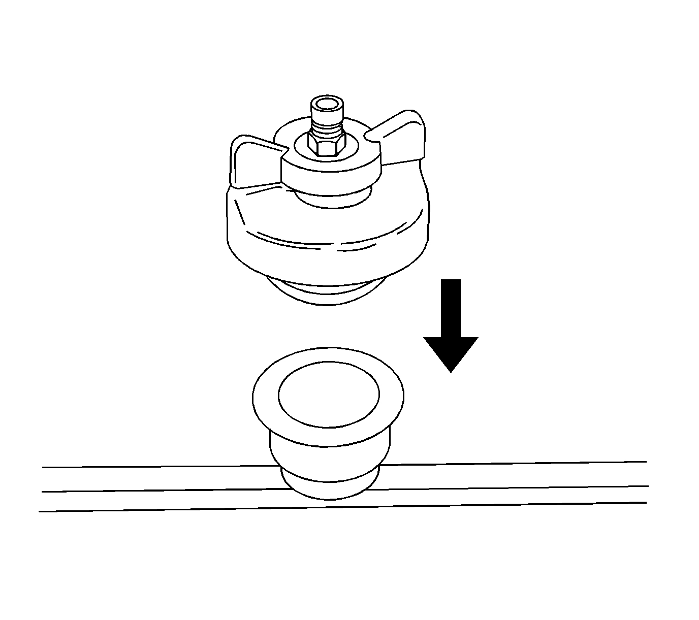

2. Attach the venturi assembly to the vacuum tank.
pic 2
3. Attach a shop air hose to the venturi assembly.
Ensure the valve on the venturi assembly is closed.

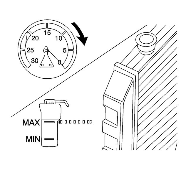

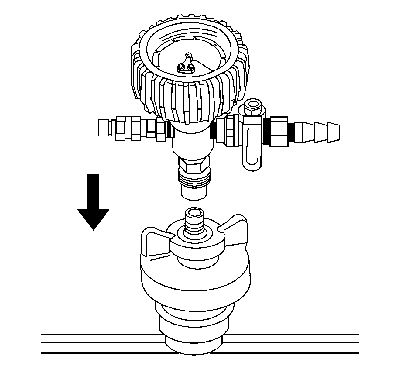

4. Attach the vacuum hose to the vacuum tank.
pic 3

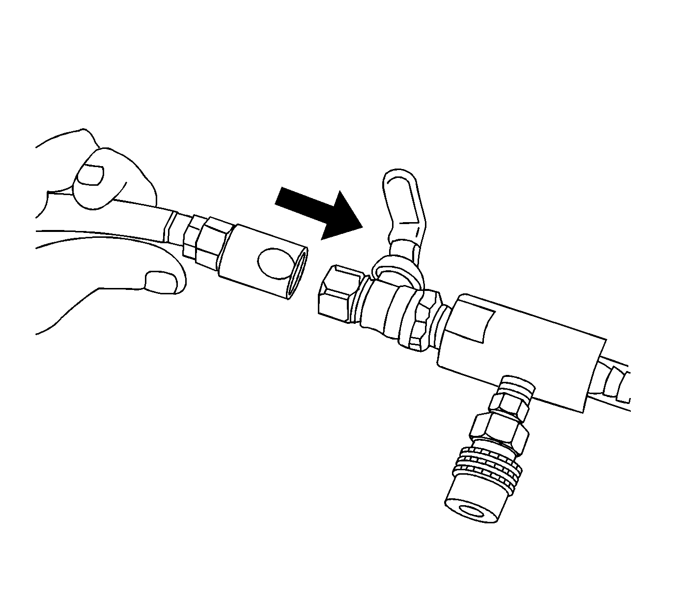

5. Attach the extraction hose to the vacuum hose.
6. Insert the extraction hose into the radiator outlet front hose until the extraction hose contacts the bottom of the radiator outlet hose.
pic 4
7. Open the valve on the venturi assembly to start a vacuum draw.

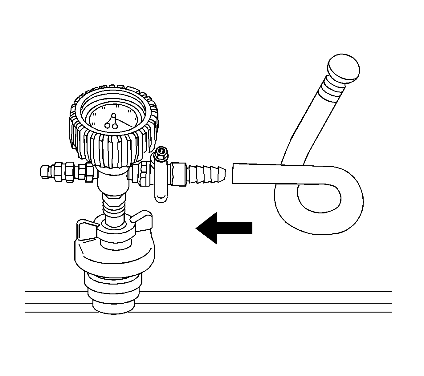

Note: To prevent boiling of the coolant/water mixture in the vehicles cooling system, do not apply vacuum to a cooling system above 49°C (120°F). The tool will not operate properly when the coolant is boiling.
pic 5
1. Install GE-42401-2 - Radiator Cap and Surge Tank Test Adapter into the surge tank fill neck.
2. Install GE-42401-3 - Radiator Cap and Surge Tank Test Adapter to the surge tank fill neck.
3. Attach the Vac N Fill cap to the GE-42401-3 - Radiator Cap and Surge Tank Test Adapter.
pic 6
4. Attach the vacuum gauge assembly to the Vac N Fill cap.
pic 7
5. Attach the fill hose to the barb fitting on the vacuum gauge assembly.

pic 8
Note: Use a 50/50 mixture of DEX-COOL antifreeze and de-ionized water.
Always use more coolant than necessary. This will eliminate air from being drawn into the cooling system.
6. Pour the coolant mixture into the graduated reservoir.
7. Place the fill hose in the graduated reservoir.
Note: Prior to installing the vacuum tank onto the graduated reservoir, ensure that the drain valve located on the bottom of the tank is closed.
8. Install the vacuum tank on the graduated reservoir with the fill hose routed through the cut-out area in the vacuum tank.

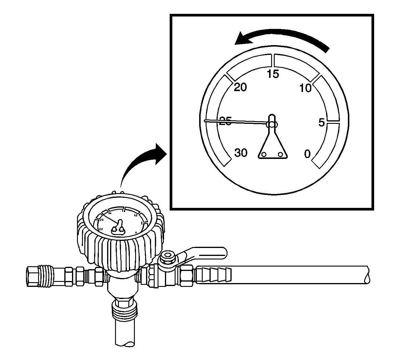

9. Attach the venturi assembly to the vacuum tank.
pic 10

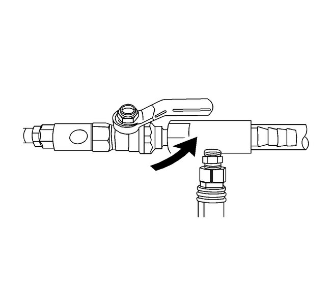

10. Attach a shop air hose to the venturi assembly.
pic 11
11. Attach the vacuum hose to the vacuum gauge assembly and the vacuum tank.

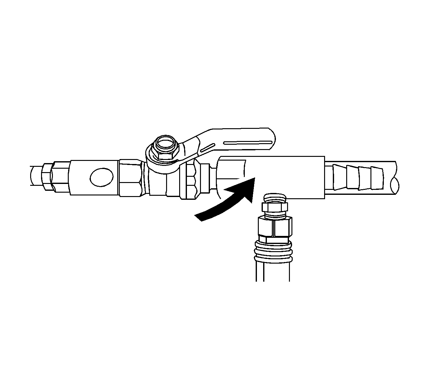

13. Open the valve on the venturi assembly. The vacuum gauge will begin to rise and a hissing noise will be present.
pic 13
14. Continue to draw vacuum until the needle stops rising. This should be 610-660 mm Hg (24-26 in Hg).

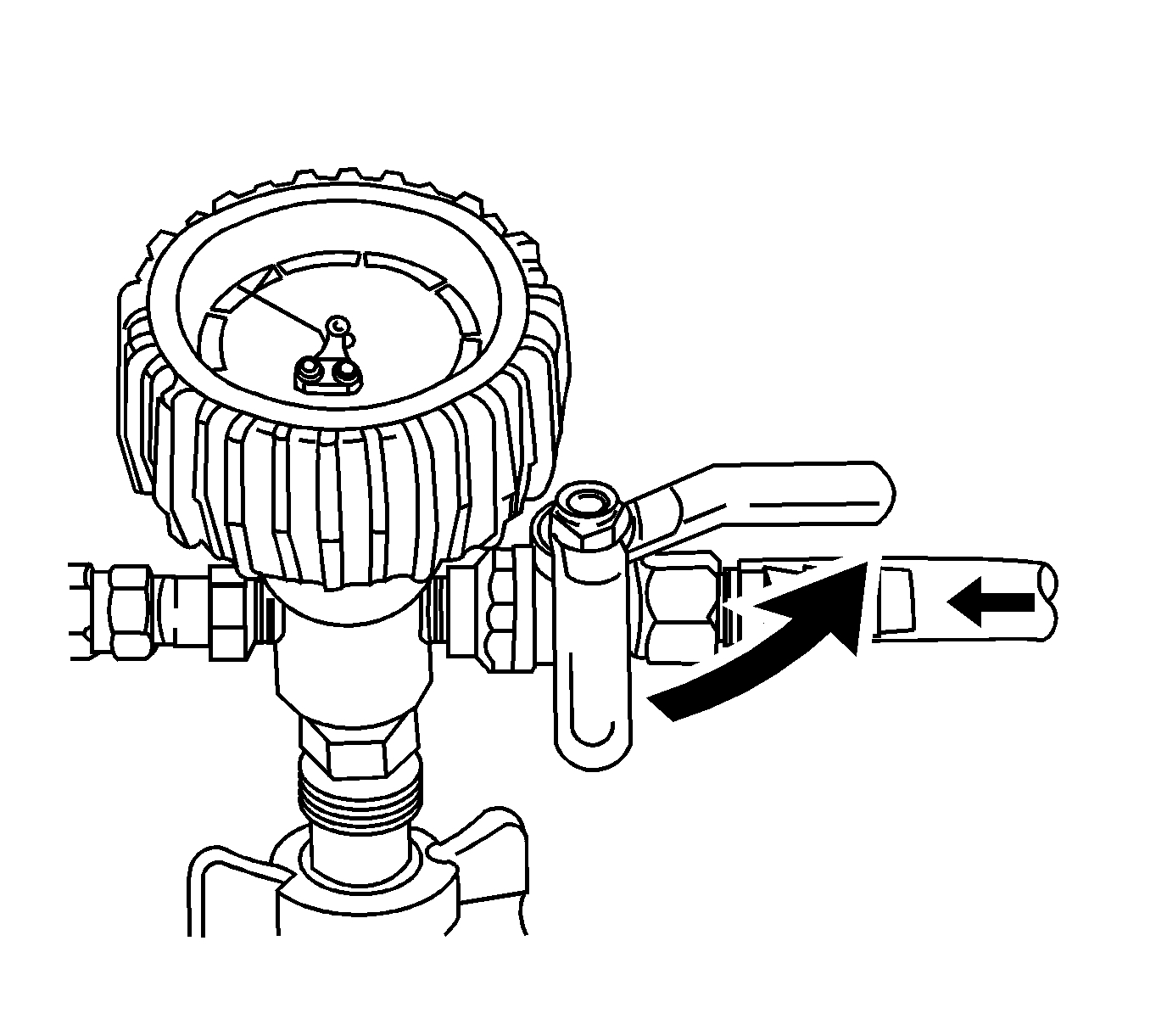

31. Repeat steps 24-30, three times.

Let me know if this is what they tried.
