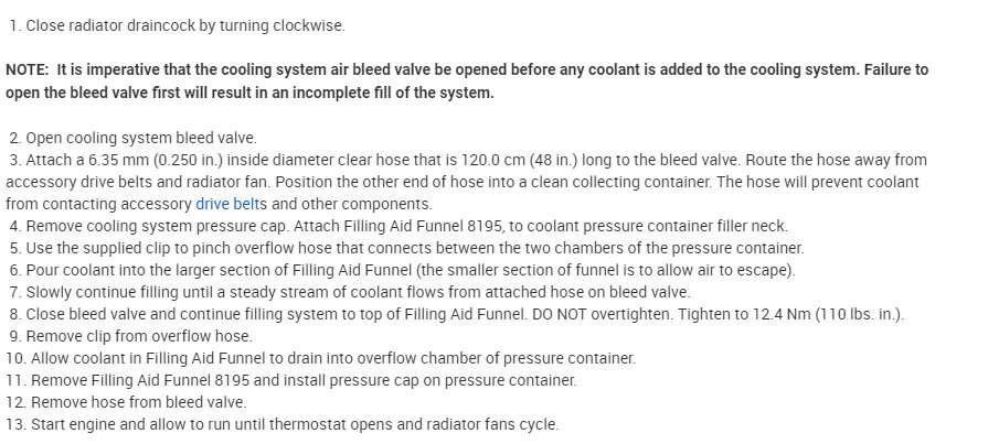

If the heater doesn't produce heat, I feel you have air in the system.
I need you to do a couple of checks for me. First, has the radiator cap been checked to see if it is good? Believe it or not, if it doesn't hold pressure, it lowers the boiling point of the coolant.

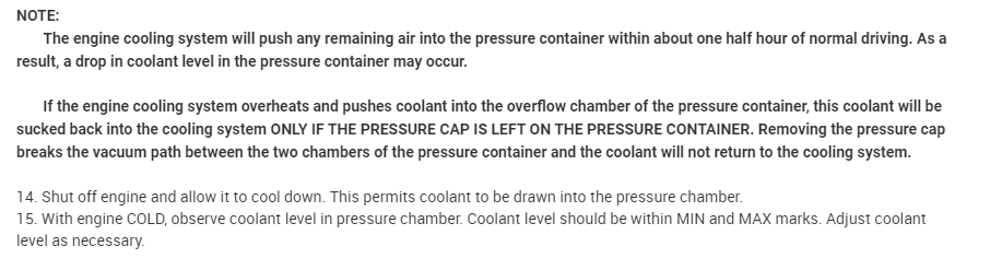

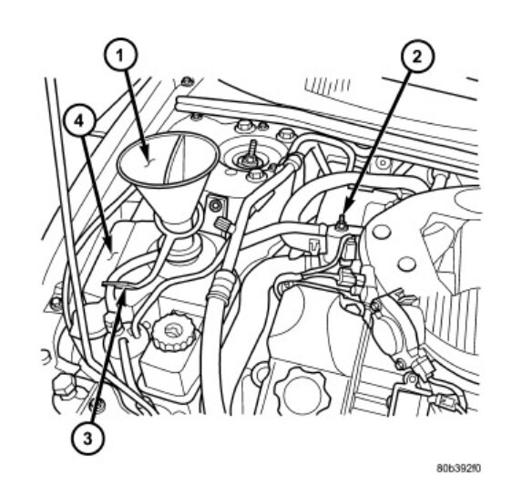

See pic 1. Number 2 is the bleed valve. Follow the directions in pics 2 and 3 to make sure you have all air from the system.
Next, turn the heater on high. Start the engine and allow it to reach operating temperature. Turn the engine off. Feel both heater core hoses to see if they are both hot. This will tell me if there is an issue with circulation, the heater core itself, or if there is an actuator issue inside the vehicle.

Hi again, we have just tried the above suggestion. We kept pouring coolant in the water reservoir, but it became full of coolant so could not add more and did not get to the point where it was overflowing in a constant stream. And now the coolant seems to be just sitting there as well and not going anywhere.
Dec 4, 2022 at 12:11 AM
  • 110,194 POSTS
If air continued coming from the bleeder, I feel this was the problem. Close the bleeder and start the engine to see if we now have heat. Also, if the reservoir is over full, try to remove some to get it to the full mark. Don't laugh, but I use a turkey baster. LOL
Dec 4, 2022 at 12:17 AM
YOUNG348
  • 21 POSTS
I forgot to mention that we took the bleeder screw completely out and only then did we see the constant flow but as soon as we put the screw in again it stopped. Thanks for your time.
