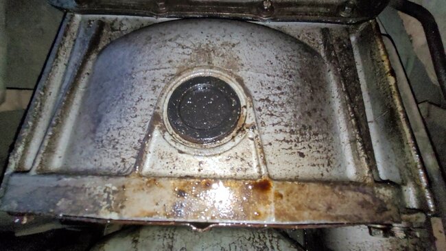

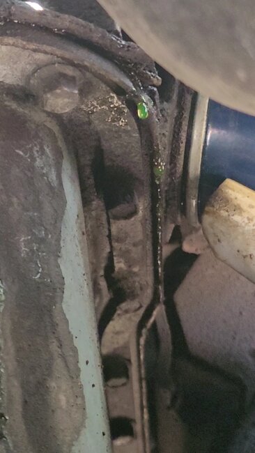

I found my other leak, well found where it's dripping at least. Is pooling up around the edge of my oil pan. I'm assuming it's not coming from the oil pan itself. Hopefully. I'll investigate a bit more this evening, but it's a start. Maybe it's coming from the water pump? That's my first guess at least. Attached a picture.

Looks like the leak may be coming from the water pump. Took a video, it zooms in on the potential leak at the end of the video. It has a green stain around the gasket. As a side problem, it seems like there's more oil than there should be as well near and around the oil pan area. Also added an image of this.
Aug 12, 2023 at 5:58 PM
  • 54,840 POSTS
Thanks for the video, it helps. It does look like the water pump is leaking, I don't think it will cause air to enter the system though. The oil leak doesn't look too bad, it could be the rear main. Let me know what happens after you change out the water pump.
