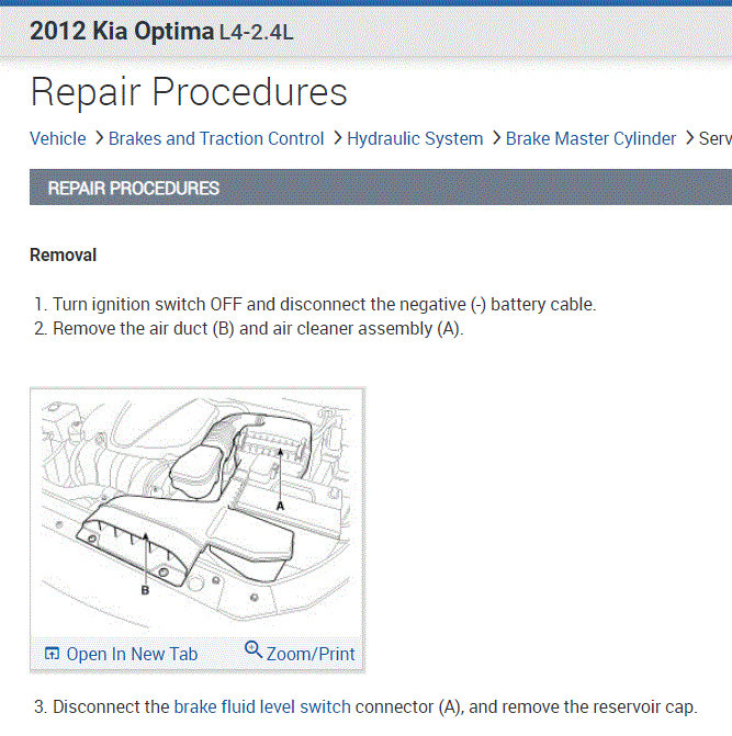

when I press on the brakes the go to the floor
2012 KIA OPTIMA
98,000 MILES • AUTOMATIC
DANIELLA GIAMPIETRO
It does not happen all the time, usually after driving for a while or stuck in traffic, when I press on the brakes the go to the floor they told me a need a new brake master.
Sep 27, 2018 at 2:04 PM
  • 110,194 POSTS

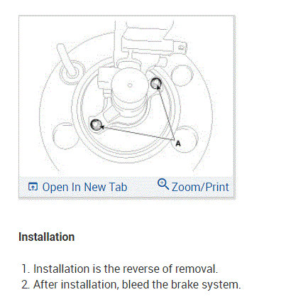

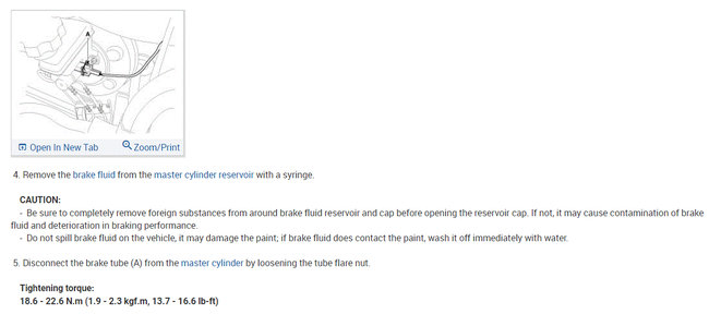

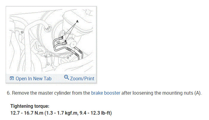

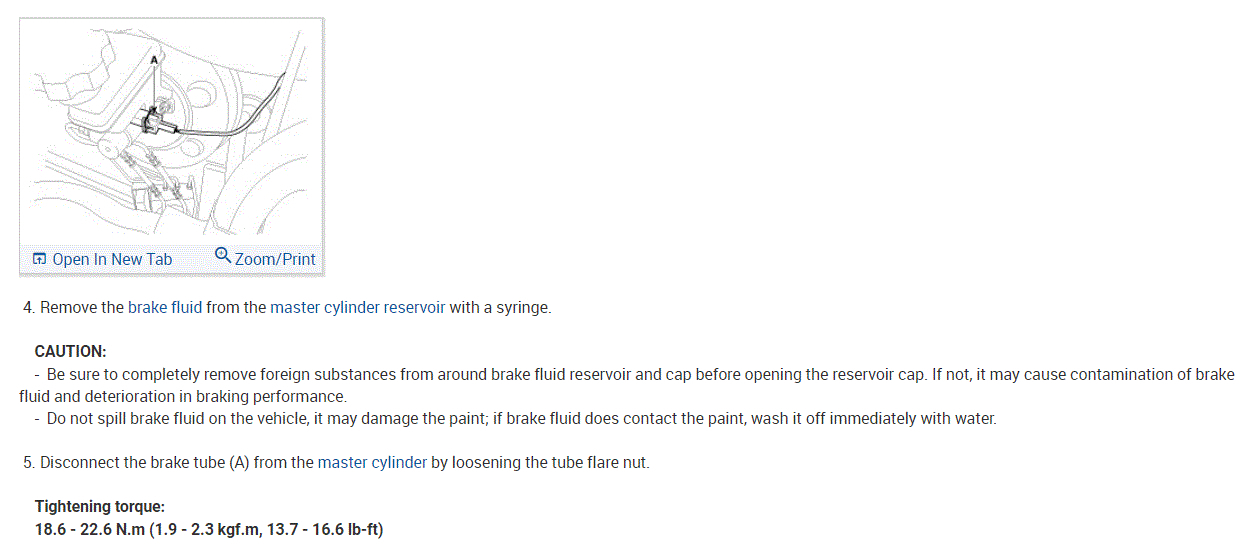

Replacing the master cylinder isn't a difficult job. If you take your time, you should have no problem.
To get you started, here is a link that shows in general how it is done. You can use this as a guide.
https://www.2carpros.com/articles/how-to-replace-a-brake-master-cylinder
If you look at the attachments below, they include the procedures for the removal and replacement of the old one.
