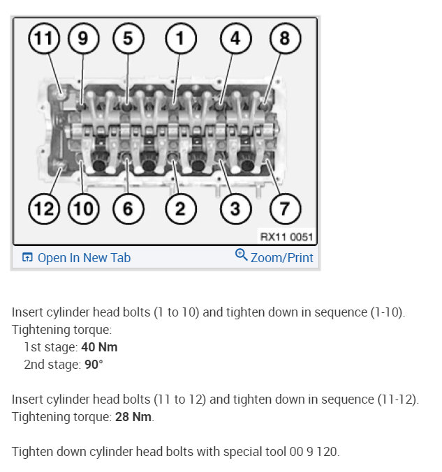

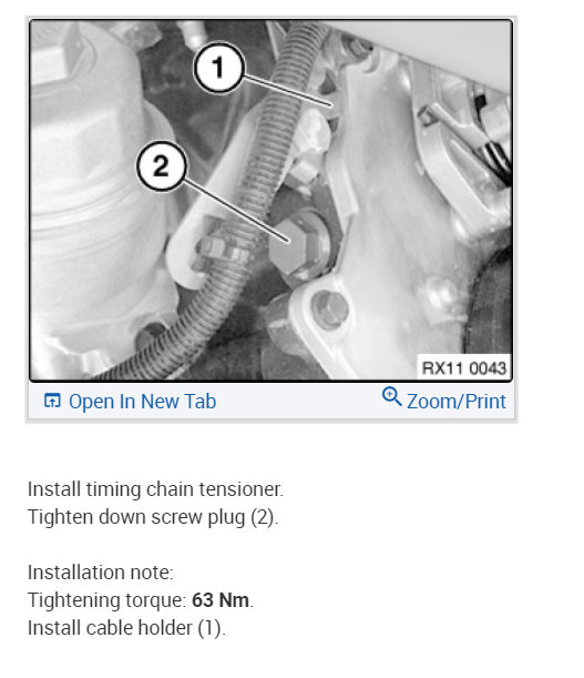

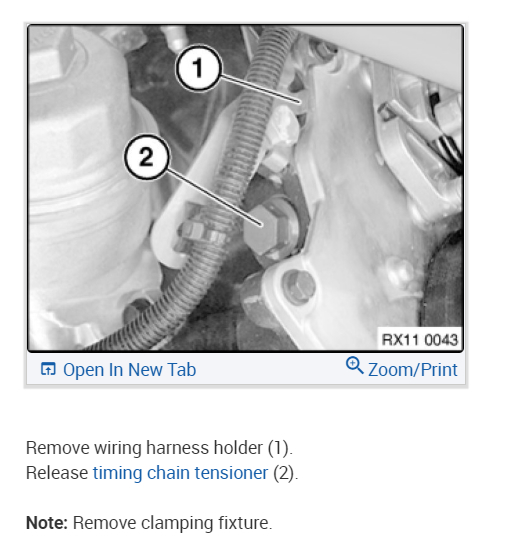

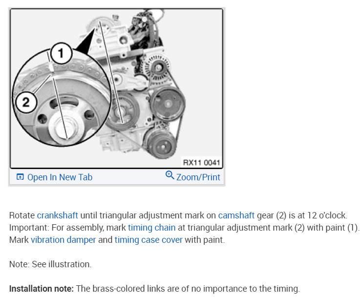

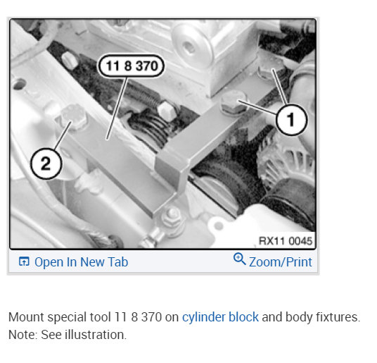

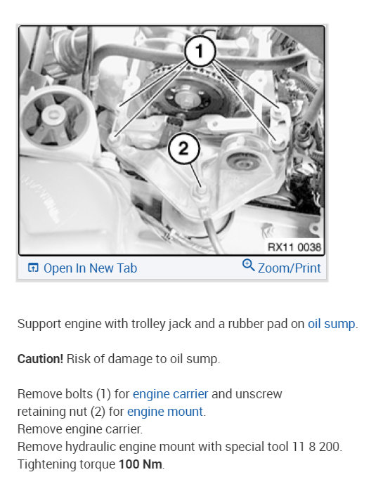

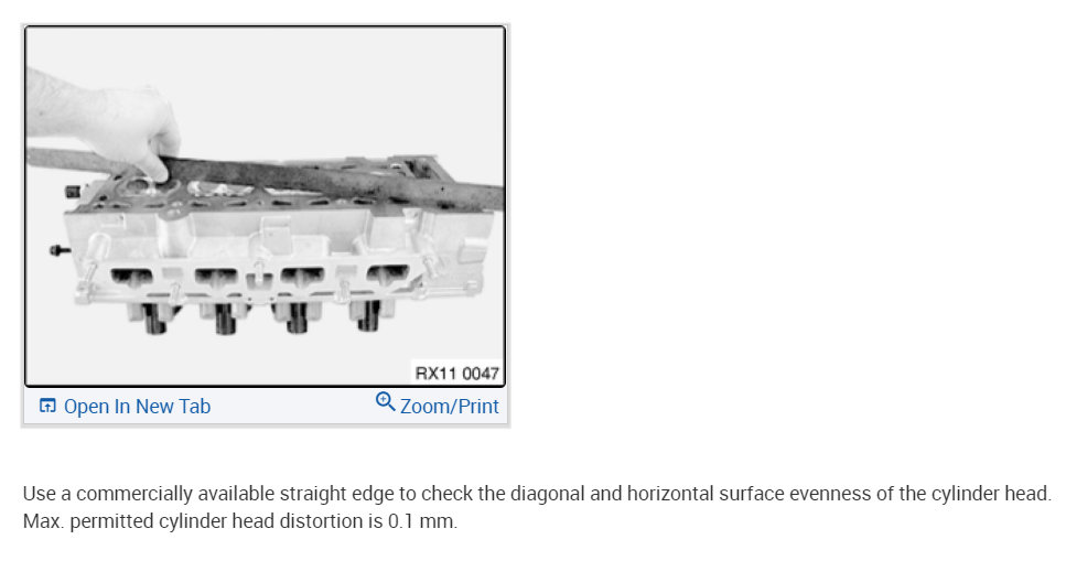

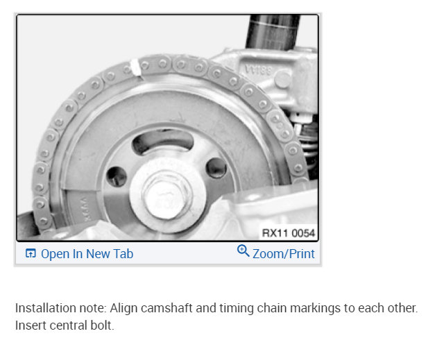

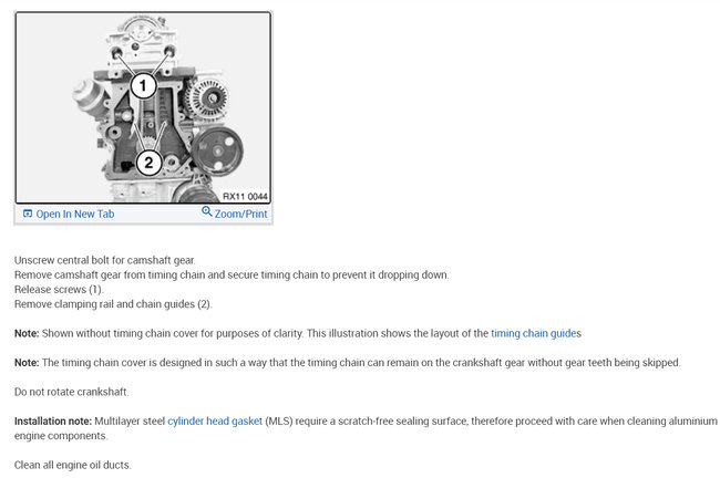

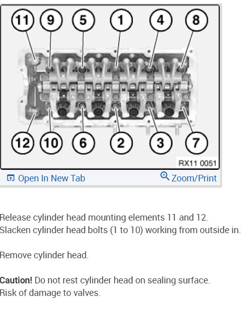

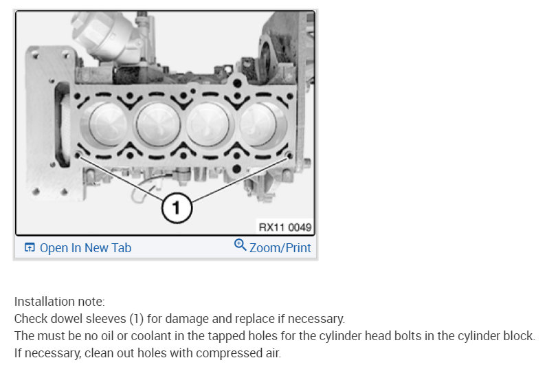

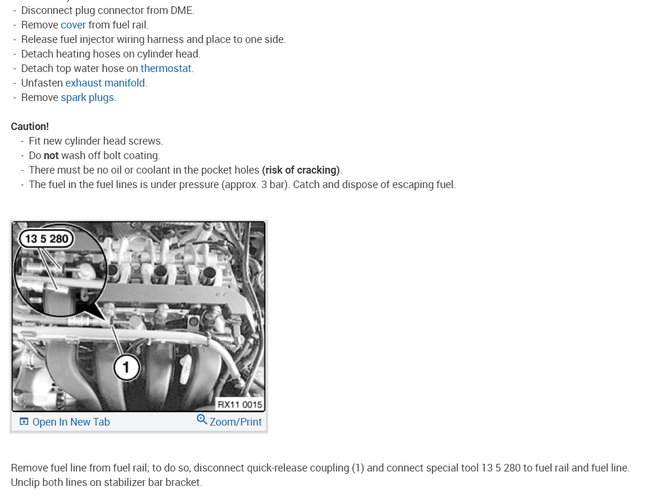

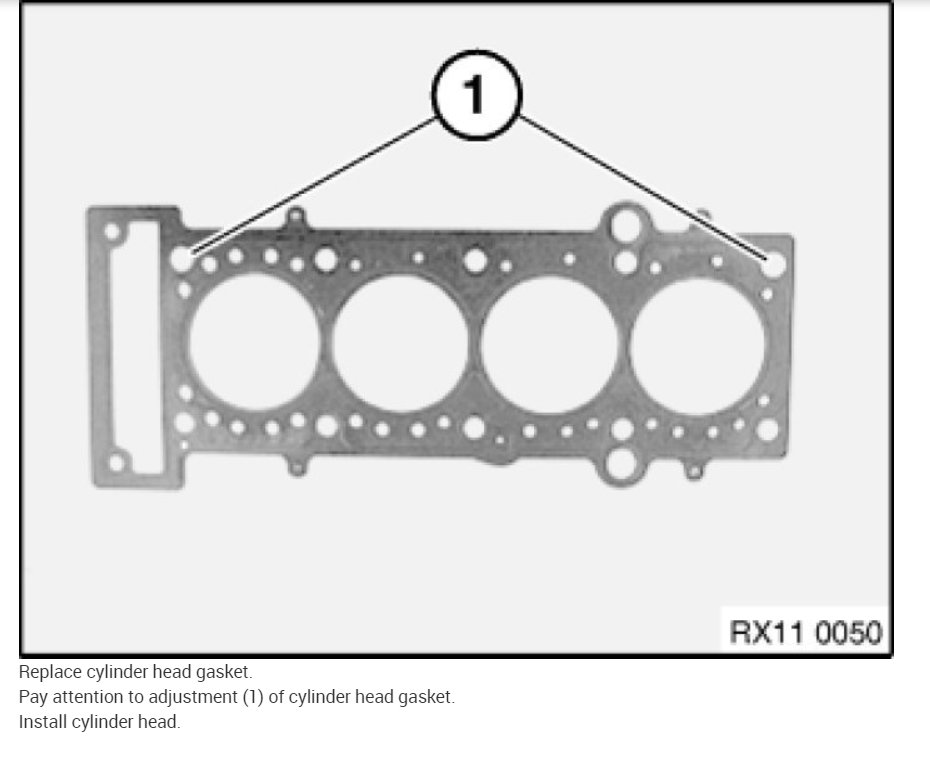

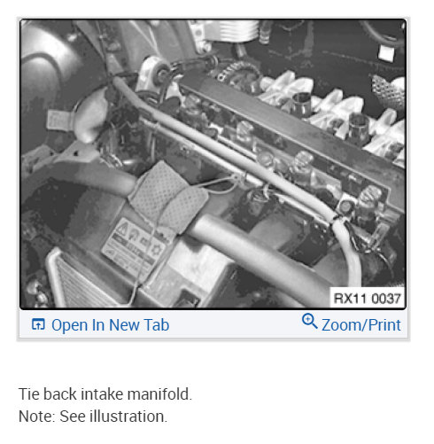

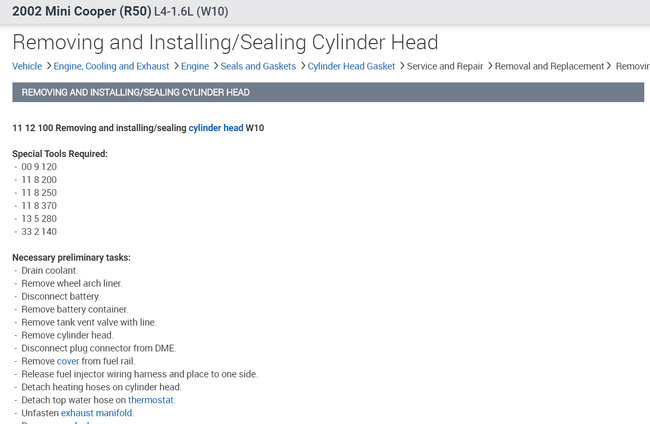

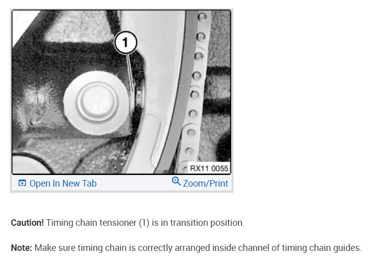

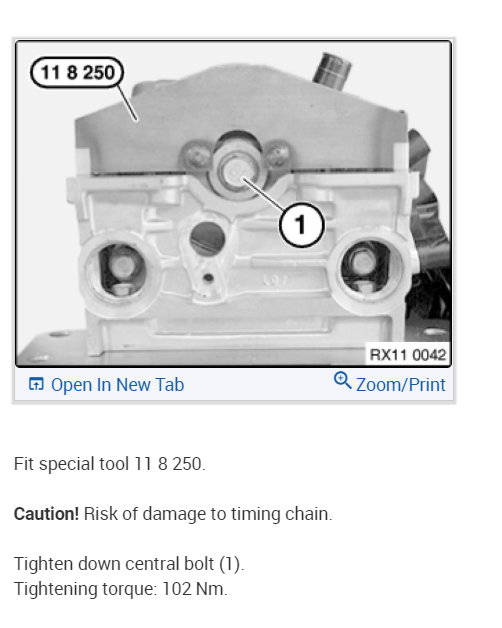

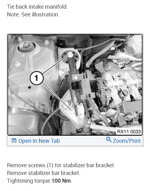

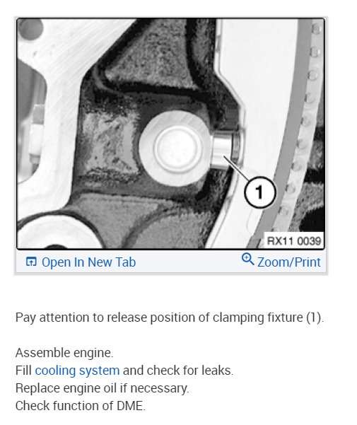

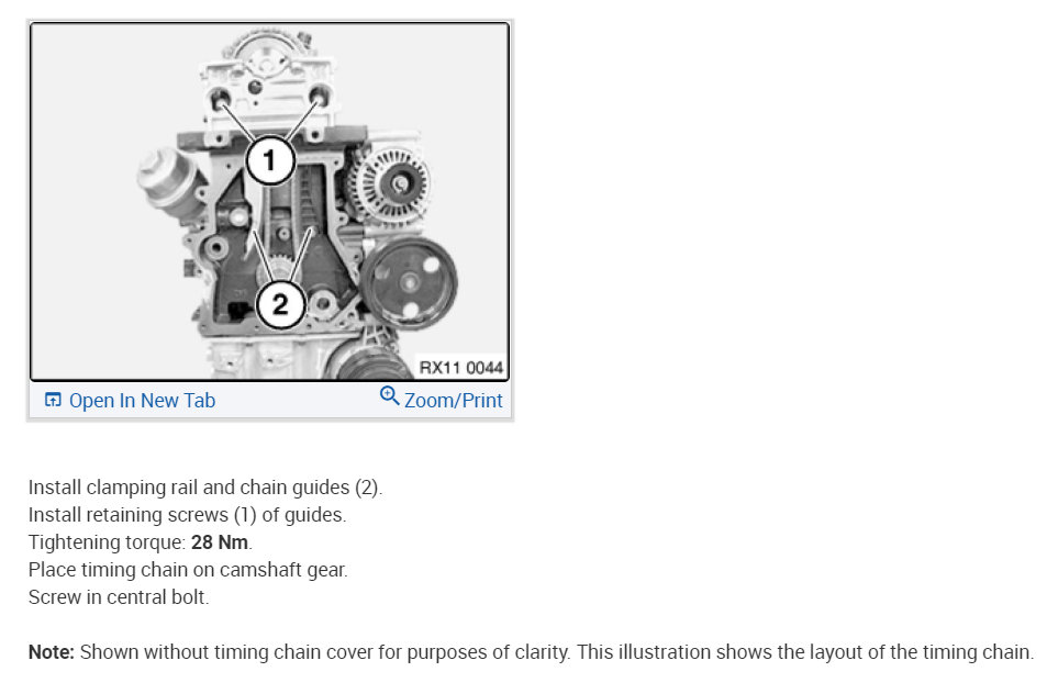

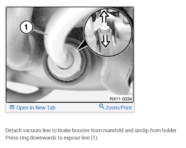

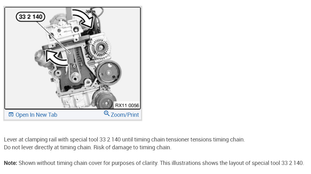

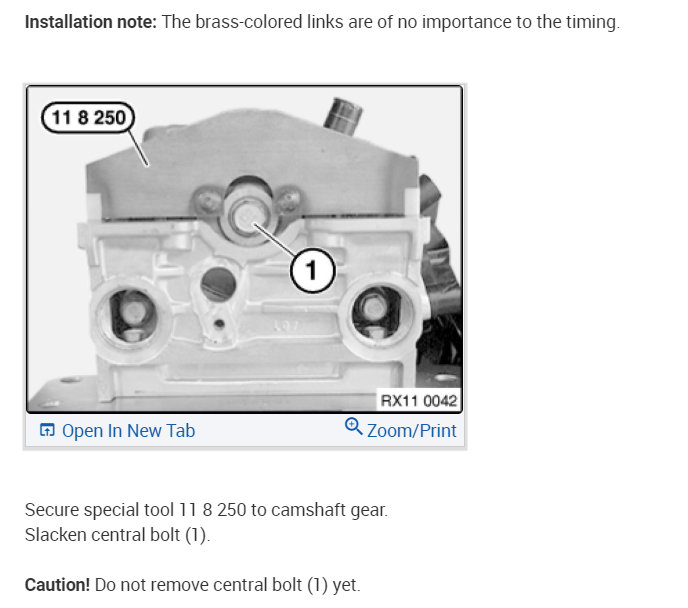

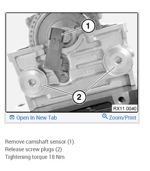

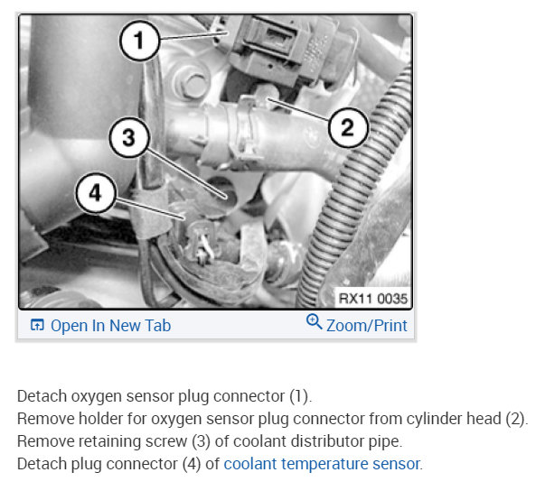

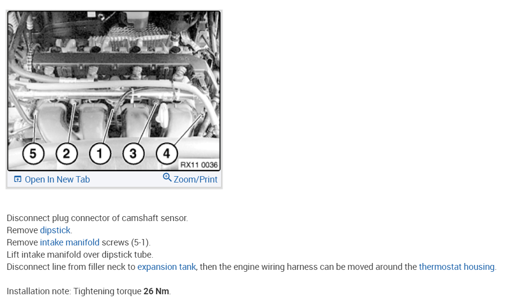

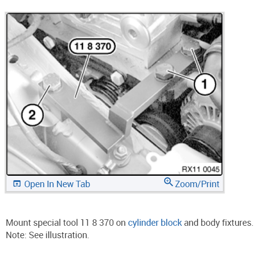

Can you please plug the spark plug or is that what you mean with the coil? If you pull the plug and it's clean compared to the rest you have a coolant leak inside the combustion chamber. here is how you can fix it:
https://youtu.be/Xi41RFMP8Ow
If you want to do the gasket here is how. Check out the diagrams (below). Please let us know what happens.
