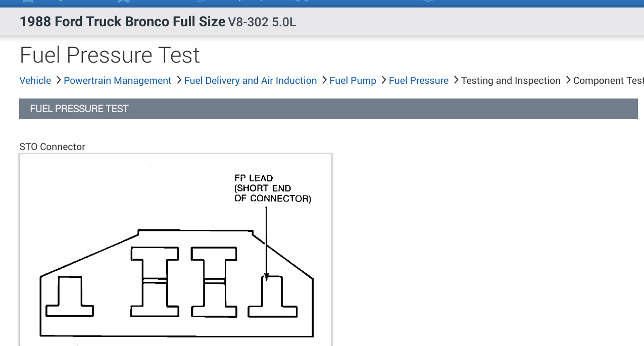

Engine cranks, sparks but does not start.
Monday, February 17th, 2020 AT 9:14 AM
SCGRANTURISMO
  • 4,897 POSTS

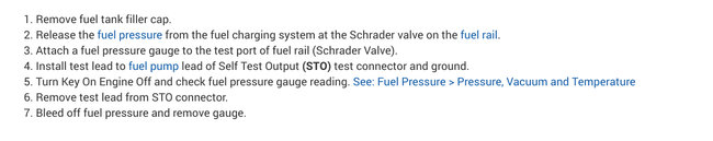

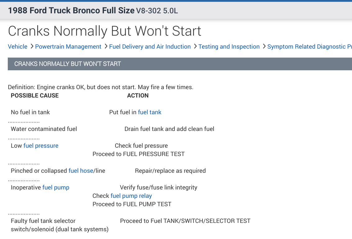

Okay, so you have spark at the spark plugs. Next let's make sure you are getting fuel. In the diagrams down below I have included a diagram with the possible causes of your No Start condition and instructions from the vehicle manufacturer on how to test your vehicle's fuel pressure. Please go through these guides and get back to us with what you find out.
Thanks,
Alex
