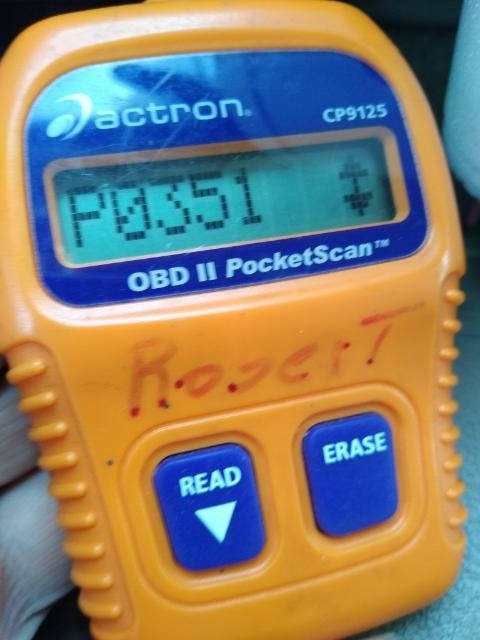

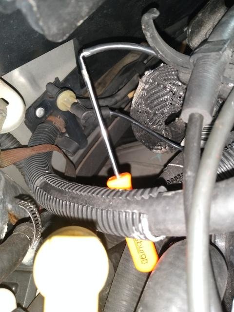

Picture shows a small white plastic device attached to passenger side of firewall with narrow vacuum line. Line, very brittle, broke and I would like to know where to attach the line and what the is used for. I think it leads to the throttle body.
Also, could anyone advise if this line, unattached as of now, could cause a misfire and a code P3501? Thanks very much.

I don't see the white device you are referring to. As far as the code, please double check that because it isn't valid for this vehicle. Last, the idea that a vacuum line is disconnected indicates there is a leak. A vacuum leak can cause a misfire, rough idle, and so on. We need to identify where it came from.
Also, let me know if you meant a P0301. That would be a cylinder 1 misfire.
As far as the broken vacuum line, there is a good chance that one end if it will go to the intake manifold. We just need to figure out the other end. LOL If you are referring to the item I circled in the attached pic, I believe that is a one way valve to provide vacuum to the HVAC controls in the vehicle. Let me know if you are having any trouble with air flow direction, temperature control and so on.

I believe you are correct in that the device, circled by you, attached to the firewall is for HVAC controls as air flow directions are a problem. I replaced the o-rings in the control device but it didn't appear to fix issue of direction.
Apologies, OBD code is P0351. Changed: Coil,TPS, Cam and crank sensors, IAC valve, cleaned EGR, MAF.

Additional Info: As I have had this issue for some time, I have been researching solutions. When you identified the part for me, I found this on another site relative to an 2003 Grand Marquis and am sending you a part that might be helpful:
"There's a vacuum line that runs through the firewall at or very near the heater hoses. That vacuum line is connected to manifold vacuum at one end and a "T" at the other with a Check valve and a vacuum reservoir. The check valve and reservoir keep vacuum on the Climate Control system when pulling a long grade or at an extended WOT. The default is defrost if the vacuum fails. Vacuum leak at reservoir, failed check valve, vacuum leak at control head."

Next, the hose you are referring to is the vacuum supply to the HVAC. I attached a pic and circled the vacuum hose you asked about. That hose goes straight to the intake manifold. See if you can find a location on the manifold that has a broken hose or something disconnected.

OBD Code P0351 was cleared after Crank sensor installed. Same code returned shortly after installation.
COP #1 cylinder was measured per your instructions and Voltage came to 12.1v.
As far as the pIug(s) are concerned, I replaced them about 9 months ago with Platinum. Recent inspection did not show damage, cracks, deposits etc. I understand that a crack in a plug might not be visible and a boot can have damage that is not clearly visible either. So, I am thinking of changing Plugs, COP, and Boots from cylinder 1 to cylinder 2, and reverse, clear code, and see if code returns and follows to cylinder 2. What are your thoughts? Again Thanks very much.

Reversed COP, boot and plug from cylinders 1 and 2. About 4 codes appeared and engine was shaking. Bought 2 new plugs, boots and coils and installed. Engine was running much better with some hesitation at times. After 3 days, after engine started stuttering, OBD Codes P0351 and P0352 appeared. Bought 2 Autolite Iridium XP Spark Plugs, gap 0.050. That's where I am right now. Will check for CEL in the next few days. Thought about new coils being faulty but figured 2 for 2 being defective is not likely, or is it?
From your assistance in identifying the Check Valve for HVAC, and the vacuum line(s):
"There's a vacuum line that runs through the firewall at or very near the heater hoses. That vacuum line is connected to manifold vacuum at one end and a "T" at the other with a check valve and a vacuum reservoir"
So, I checked, with suction, on the line going to the vacuum canister. Line could not hold vacuum. Replaced check valve, vacuum holds now. Still cannot locate the fitting for other vacuum line that has broken.

Yes, the codes returned, P0351 and P0352, once with CEL and once without CEL, after some shaking of engine coming from stop light.
The image you circled for me : One way valve to provide vacuum to the HVAC controls has two vacuum lines: One to the vacuum reservoir, the other, a very narrow one to? Thanks again for your assistance.

As far as the vacuum line, one should go to the intake manifold and then to the HVAC. is the narrow one made of plastic and not rubber?
Jun 30, 2020 at 2:45 PM
SMORAQ
  • 8 POSTS
Is the narrow one made of plastic and not rubber?
Yes, like a coffee straw or even narrower.
Jun 30, 2020 at 3:45 PM
  • 110,248 POSTS
That's sounds like it's plastic. They are known to dry out and crack. Once you get to the end of the plastic hose, there will be a rubber hose pushed over it which will attach on the opposite side.
