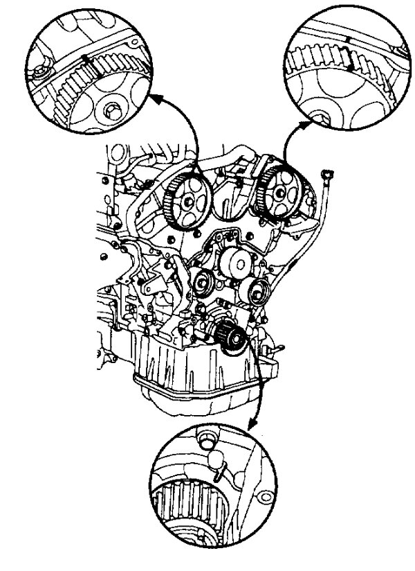

After replacing the broken timing belt there is a code saying camshaft sensor high input?
220,000 MILES • 2.7L • V6 • AUTOMATIC
IBINIB
  • 15 POSTS
My timing belt broke I replaced it, and timing marks/crankshaft is spot on, but I did get a code saying camshaft sensor high input! Did the sensor blow when the timing belt broke? Now when cranking the engine it makes a winding sound. Don't know whether it's a crankshaft sensor or camshaft sensor.

I need to hear the engine cranking to confirm my thoughts. However, this is an interference engine and if the belt broke while it was running, there is likely internal damage such as bent valves. If that is what happened, that will cause compression loss and the sound you described when cranking.
If possible, record it cranking and upload it for me to hear. If you can't, do a compression test to see if there are low cylinders.

  • 15 POSTS
When cranking the engine over crankshaft camshaft drive belt is spinning but won't start there was a code after belt broke PO342 tested camshaft sensor for voltage range 5 to 7 brand new starter and battery/alternator are good! Disconnected the positive and negative to the battery so the ECM could drain I unplugged the fuse to the ECM. What else do I need to look for?
Dec 12, 2024 at 2:04 AM (Merged)
  • 55,743 POSTS
The camshaft sensor will not make the engine not start, I would see if the engine runs on starting fluid. Does the engine sounds okay when it is cranking over? it might not have compression if you unload a short video of the engine ranking I can tell for sure what's going on. Please go over this video which can help see what is missing.

  • 55,743 POSTS
Yep, it sounds like you have no compression. So the timing marks are off or the valves got bent, I would recheck the marks of the timing belt. Thanks for the video it helps. Here are the marks for the timing belt. Check out the images (below). Please let us know what happens.
