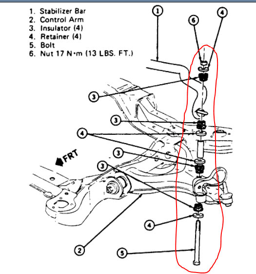

I was driving down the highway about 50-55 MPH. I stepped on the gas and acceled quickly. In doing this the car shook hard in the front end. It only did this when accelling. I let off the gas and held the petal down enough to maintain a speed of about 65 MPH. I let go of the wheel and the car held itself straight while driving. I accelerated with my hands off the wheel, the car pulled immediately to the right, the passenger side so I grabbed the wheel to keep it on the road.
I later looked under the car while it was parked and saw that the linkage on the passenger side sway bar was broken in half, the bottom part that hooks into the frame I couldn't see, only the top half of the linkage bar. It was clearly broken. I looked at the driver side and it was wearing very thin, I didn't see if it was broken or not.
Would this cause what I've described while driving it?
I'm looking to possibly buy this car, the engine is good, the price is right but I'm wondering about this problem.

Keep looking. Anti-sway bars reduce the body's tendency to lean to one side when cornering at high speeds. Beyond that, they don't do anything. Before the mid to late '70s, a lot of car models didn't even have anti-sway bars.
What you're describing is called "torque steer". It was a characteristic of some older front-wheel-drive models, and was more noticeable on high-powered cars. The biggest contributor to torque steer was unequal length front half shafts. That has either been addressed by using a two-piece right half shaft, or by design changes to the geometric relationship of the steering and suspension parts, by every manufacturer. Today torque steer under moderate acceleration is usually caused by worn or loose parts. Something is allowing the alignment to change between braking and accelerating. Things that can cause that include ball joints, tie rod ends, badly-worn and leaking struts, and control arm bushings. Control arm bushings used to last the life of the vehicle, but for a long time softer rubber compounds have been used to improve ride quality.

The sway bar links are insulated with 4 rubber bushings each. They wear out just like any other rubber component from age, rot, weather, etc. Once the bushings have deteriorated and crumbled away it leaves the nut and bolt to clank around, fatigue and eventually break off. The link assemblies are not that expensive and are readily available at auto parts stores. I've attached a picture below of the assembly and circled in red. Hope this helps and let us know if you have any further questions on this issue. thanks for using 2CarPros.
