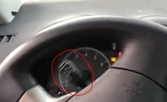

I was driving and my lanyard got stuck around the wheel while I was turning. I forced the turn anyways to avoid an accident. Now when my car is fully started, the steering wheel turns 360 degrees and the steering wheel light briefly comes on. Why is that happening and how do I fix it?

Can you get a video of what the wheel does? I think I understand but seeing a video will really help.
When you turn the wheel do the front tires respond to you turn the wheel?

The wheels does respond but they don't turn any further than normal. It only does this when the car is started.

I'm just curious to know after this accident happened one thing .. The headlight and turn signal (combination switch) stays stationary on the left side of the steering wheel. It looks to be that the right side switch that is stationary is the windshield wiper controls. I'm curious to know the lever that spins while turning the steering wheel what that controls? Was this damaged during the lanyard damage? Should this be stationary as well? I've reattached a picture you supplied and circled in red to ask what my question is.Hope this helps us further address the problem.Hope this helps and thanks for using 2CarPros.

That always moved with the steering wheel. I'm pretty sure it controls the cruise control.
Jun 3, 2020 at 1:11 AM
In reviewing that video, is that as far as the wheel turns or are you able to turn the wheel the normal number of rotations? Maybe get a video of you turning the wheel all the way to the left and then all the way to the right.
At this point, I am just suspecting there was damage done to the clock spring which is the component that connects the steering wheel electronics to the steering column electronics. This is why the steering wheel light is coming on but I am just not clear on the turning 360 issue so the new video should help with that.
