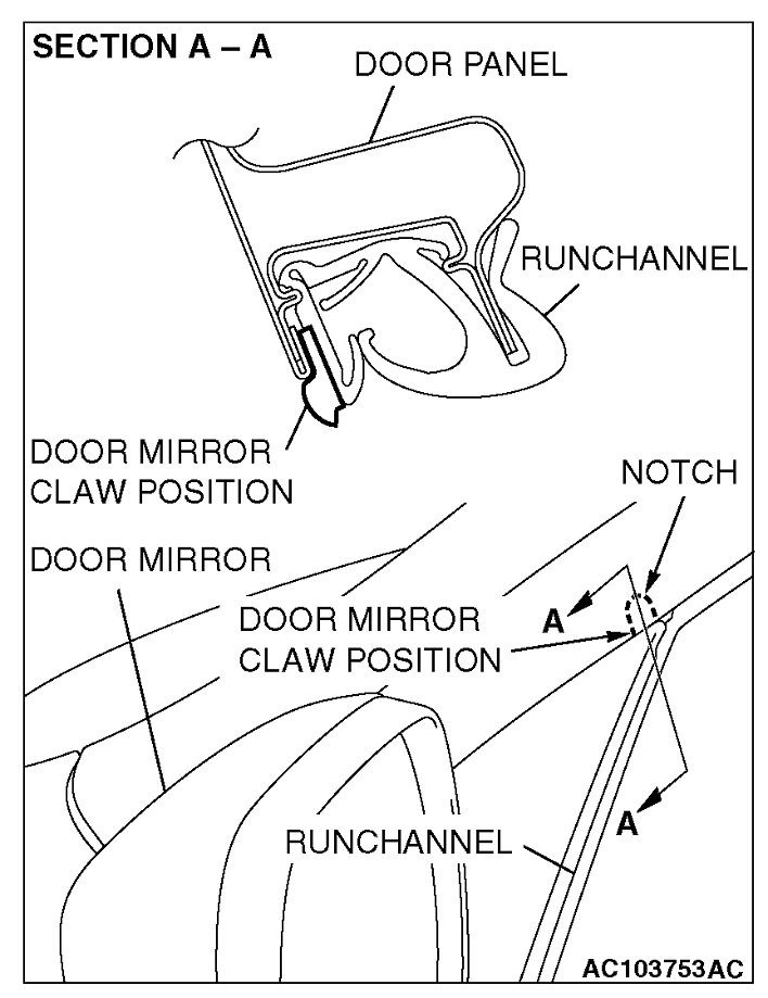

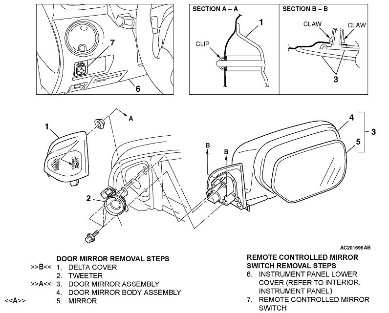

Hello, I broke my side mirror glass when backing up. I wanted to ask you how can I remove it. Thank you.
Mar 17, 2021 at 12:58 AM
CARADIODOC
  • 34,381 POSTS
What do you want to remove? If you want to replace just the glass, visit a shop that replaces automotive windshields. They can remove the old glass, and they usually have pre-cut replacement mirrors in stock.
If you want to replace the entire mirror, here's the instructions for that:
Drawing 1
Drawing 2
CAUTION: The claws of the mirror are prone to breakage when working in cold temperatures. Always warm up the mirror claws and their periphery to 20 °C (60 °F) or higher before handling.

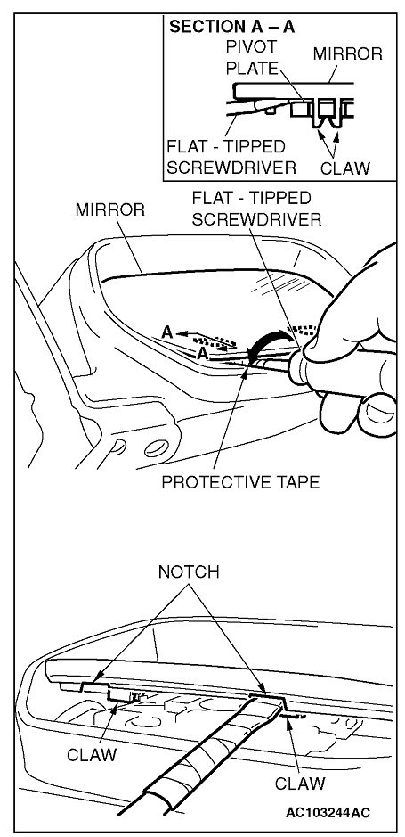

Slant the mirror upward with your hands. Then insert a flat-tipped screwdriver wrapped with protective tape between the pivot plate and mirror through the notch from behind the mirror. Now pry off the mirror claws and remove the mirror as shown.

CAUTION: When assembling the door mirror, check to see that the claws of the door mirror are inserted into the notch of the front door run channel.

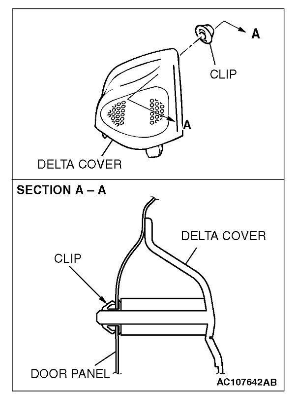

]]B[[ DELTA COVER INSTALLATION
Drawing 4
CAUTION: If the delta cover is placed with the clip on the door panel, the clip may be pushed into the door panel and fall off. Thus, special care is necessary.
Install the delta cover with the clip installed.

Thank you for your reply. I just need to change the glass but unfortunately where I live shop like that is like 100 miles away. Can you suggest any tips how I can change it myself I already ordered a new glass?

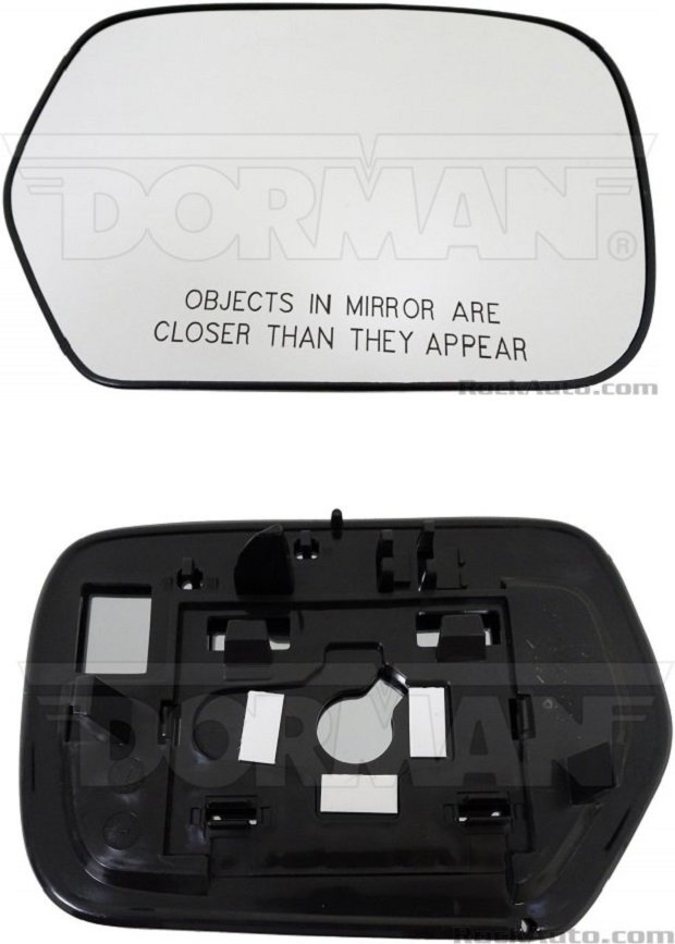

I'd wait to see the new piece first. That way you can see what is involved. For example, the instructions make reference to "claws". I could imagine those as being some type of clips that snap into place. Those clips would be molded as part of the plastic frame the glass is glued to.
While there still might be a plastic frame that is snapped in, you might get only the glass that has to be glued to it. If that is the case, consider using a hot-air gun to soften the glue so the old pieces can be pulled off. You should be able to hit a spot where the glue is softened, but not yet hot enough to melt any plastic parts.
Here's a photo I found on the Rock Auto web site. Everything points to the glass as coming as part of an assembly. It sounds like this just snaps into place.

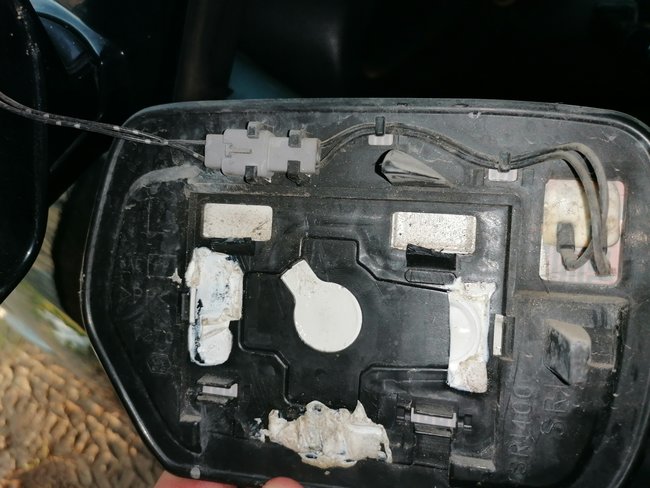

Hello there. Update: I got a call back from the company I ordered the new glass from. They don't have it they said they called some of there, colleges" they don't have it either. There are like 5 cars selling for parts here so I was thinking if it would be possible to reuse a old glass and would it get destroyed somehow while being removed from the mirror?

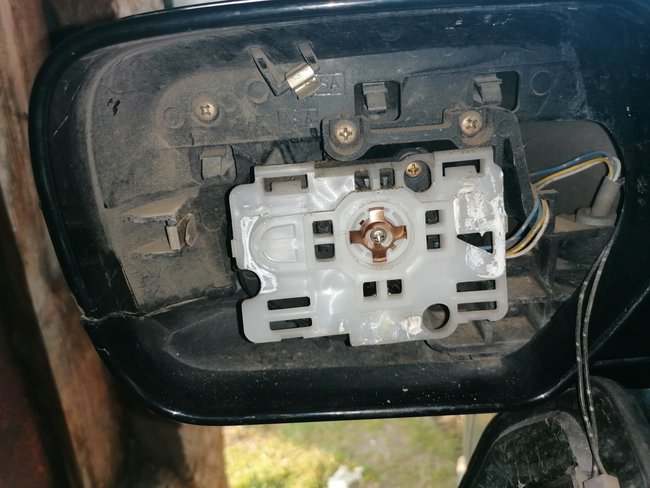

Since yours is already broken, there's nothing to lose by tugging on the plastic frame to see if it will snap off. Once you have it off, you can see what holds it on and if there's an easy or better way to remove a good one.

Thank you so much for all your replies you've been very helpful and I wish you all the best. I removed this sucker and turned out it was both glued and had claws. I saw some cars online for parts two are the same colors as mine so i'm thinking I might order the whole mirror because this thing is a bear to remove and I don't know in what condition the seller is going to send it. Also the bottom plastic part of the mirror is a little busted anyway so I think it's worth it to just change the whole thing. I could have not found a brand new glass anywhere a whole new mirror costs like $180.00 here, so I am about to call some places tomorrow and hopefully I can get a good deal on a new one...
