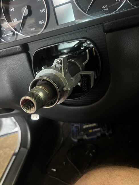

Hello. I recently changed the clock spring and turn signal assembly on my 2007 Mercedes In the process, I over tightened the screw that holds the assembly to the steering column. I broke of the tab that the screw runs through to hold the turn signal aaaembly safely to the ateeeing column (it was brittle). Do you happen to know of a cheaper solution than buying a new part?

Are you referring to where I added a nifty red arrow to your dandy photo? If so, there is a product just made for this. The name of the company is "Belzona". They make a product you mix similar to epoxy, then once it has cured, you machine it and drill and tap it just like metal. They have another product now for rubber too. Both are intended for the paper mill industry. A common use for it there is to repair the ground-up surface where a bearing rides on a large roller. It could take weeks of downtime to order a new roller from overseas, but in an hour or two, the surface can be coated with the metal product, then machined on a lathe and be back in service the same day.
Their rubber material is used to make mounts such as engine and transmission mounts on cars. You stick a large bolt head into a cup of the product, then pull it out when cured and you have a new mount.
There's also epoxy and "JB Weld" which is like epoxy, but I don't know if those can be machined like metal. If you have either of those, I would try to glue the old piece back on, coat the screw lightly with oil or light grease, then run the bolt in part way. Once cured, run the bolt back out, then assemble the parts. Having the bolt in place will prevent the epoxy from filling the screw hole, and the grease will prevent it from gluing the bolt in place. If no other parts will interfere, build the glue up around the repair for extra strength. This is a place where super strength is not needed. The main goal is that parts don't rattle and are held in proper positions.
If something slides over or next to the broken tab, install that part while the glue cures. Put a piece of masking tape, or paper, on the part to prevent gluing the part on permanently. The part will form the mating surface in the glue. Once cured, pull the masking tape off, then reassemble the puzzle.

Thanks for the info , BUT, unfortunately the piece was so brittle that when I overtightened the screw, it shattered and cannot be pieced back to reassemble. The arrow is in the perfect spot though!!

Then the Belzona product is the better solution. I mentioned putting a light coating of grease on the bolt threads, but as I recall, they have a mold release agent used specifically for this purpose.
The idea is to build up the product where you need to create the new tab, and set the bolt in place while the material cures. After you remove the bolt, you'll likely need to shape the glob into a tab to match the original, particularly if another piece butts up to it.
If you're repairing a part made of aluminum or white metal, sand the surface clean first, then wash it with a cleaner that evaporates leaving no residue. Apply the glue right away, within a few seconds, if possible. Aluminum corrodes right before your eyes from nice and shiny to a dull gray. That layer of aluminum oxide insulates it from corroding further, but that layer adversely affects how well the glue will adhere.
Let me know when you make some progress.
