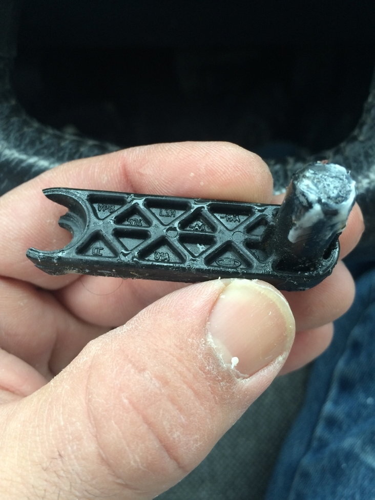

I have found that the reason my vents won't change is a broken lever that the actuator is moving. I however can't seem to find any info on this part that appears to come off. Can you direct me on where to find this part? Seems silly to replace the entire system because of on part that can be changed.

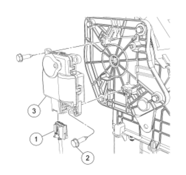

The mode door actuator shouldn't have a lever. It should key into the mode door at the side of the HVAC box.
I attached a pic below. Do you see the part you are referring to?
Feb 3, 2023 at 6:04 AM

It is behind the plate that the actuator attaches to. Between that plate and the actual HVAC box. Included a picture of broken part.
Feb 3, 2023 at 7:06 AM
  • 110,240 POSTS
I looked at the pic. Am I correct in saying the broken section is where the actuator connects? Also, do you have the HVAC box taken apart?
Feb 3, 2023 at 7:12 AM
TERRAPHIN
The actuator connects through the black plate into a white wheel that moves this lever and some other ones. Actually, this picture is from the only reference I could find. It is on the F150 forum, so no I have not taken mine apart yet. I was hoping to have the replacement before I get into it.
